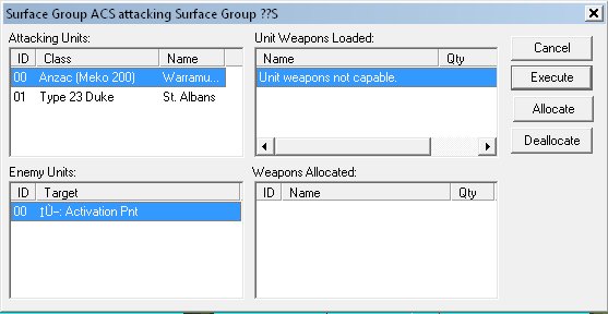

  1. HCE 2009-008 ============== - Chg:2429 GE Fixed the 10x too large BOL range ring. (thanks Herman) http://harpgamer.com/harpforum/index.php?showtopic=2471 Confirmed as fixed. - Chg:0000 GE Only show BOL range ring as large as BOL capable weapons instead of as large as the longest range ASM/SSM. Confirmed as fixed. - Chg:0000 GE Made the BOL range ring yellow like it was meant to be. Confirmed as fixed. - Chg:0000 GE Added a Staff Assistant information message when the group has no BOL capable weapons and a BOL attack is attempted. Confirmed as fixed. - Chg:0000 GE Don't let weapons launch their own BOL attacks. (thanks Herman) Strongly believe that it's fixed based on tests I've run. - Chg:0000 GE Fixed inability to retarget air groups already on a mission. Confirmed as fixed. Even the ASA is back in business. However, Hotkeying a BOL brings up some gibberish on the WAD for Enemy Units Target. See screenshot attachment. There are two small test scenarios to play with: BOLTEST for WestPac and REAC for EC2003. BOLTEST.zip REAC.zip
