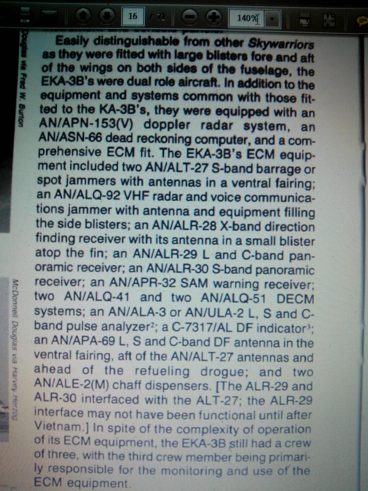

EKA-3B Skywarriors (1968?-1989): tanker and jammer, perhaps only with RWR but not ESM. 4xALQ-86 ECM fuselage blisters, ALQ-126 and ALQ-100 SLAR. 34+5 planes, converted from KA-3B and A-3B. Estimated ranges: 2520 nm in ECM patrol, and 2867 as tanker.
I believe the EKA-3B fuselage blisters held ALQ-92 jammers (mostly for jamming GCI datalinks). The ALQ-100 was a track breaker (DECM), but I am not sure the EKA-3B also carried the ALQ-126 (another, later track breaker). Source(s)?
Yes, most probably ALQ-92, as stated here:
http://www.designation-systems.net/usmilav/jetds/an-alq2aly.html (probably with ESM, ALR-28 and others).
and here:
http://www.ausairpower.net/TE-Tacjammer.html
I think it was one of my old notes, I believe based in a 1980s Air Fan magazine description.
Also, were most or all reconverted to KA-3B from 1975 without ECM gear.
(in another of my cryptic notes, about ALQ-100: "E/F/G/H-Band Track-Breaker ¿Also designation for SLAR in early EKA-3B?", probably based in another old erroneous description).
About the EKA-3B ECM gear fit, at last I think that can be an ultimate answer, as stated on page 28 of Rene Francillon with Ed Heinemann's (!!!) "Douglas A-3 Skywarrior", Aerograph 05, Aerofax 1987:
APN-153(V) doppler radar (navigation?).
2xALT-27
ALT-92
ALR-28
ALR-29
ALR-30
APR-32
2xALQ-41
2xALQ-51
ALA-3 or ULA-2
APA-69
2xALE-2(M)
