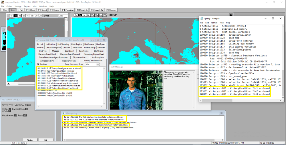

  • Update:  I am down a deep rabbit hole on VCs at this point and want to document a bit before chasing the rabbit some more. Changes Made: Victory conditions are checked every two game minu
  • Broncepulido brought this up again via e-mail, a bit different situation.  If there is no minimum victory condition defined for a side, should the game evaluate the Total victory conditions?  I think
