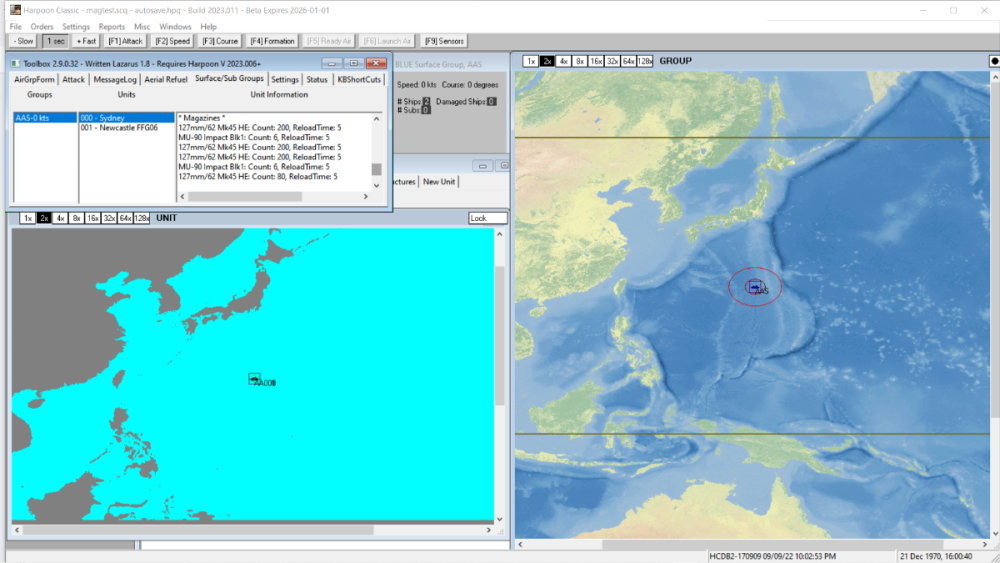

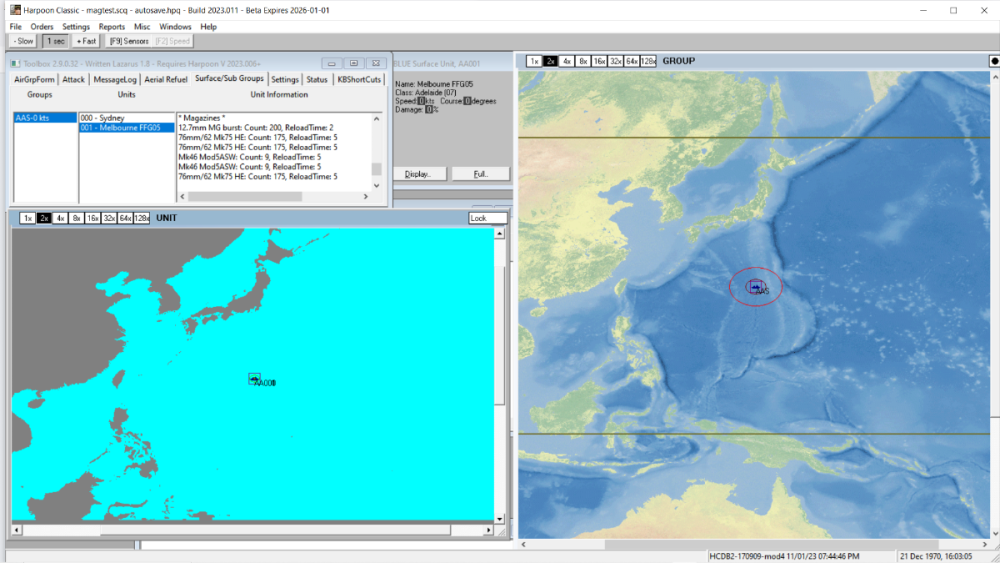

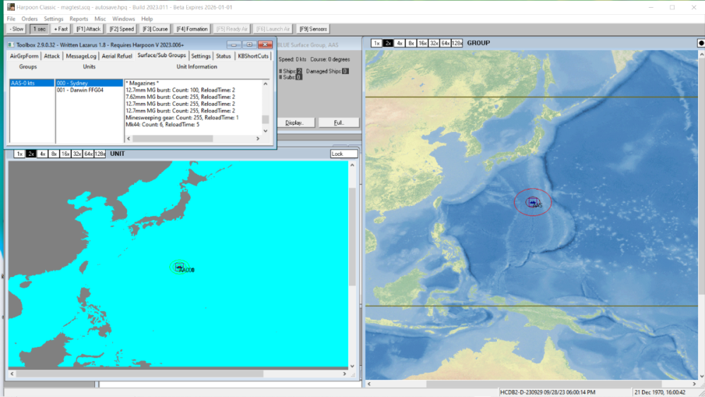

I don't know if this helps. I have two edtided versions of hcdb2, one form sept 22, one from recently. when used in a test scenario the 2022 comondb is good, the 2023 shows errors in the mag. I have a couple of screen shots here and attach a zip with the two commondb files and the pair of pf files. in the PE the mag looks good.
image.thumb.png.0dd2ce1c9a4d2f9eba3a25e5caa0b4fb.pngimage.thumb.png.c8544c93283ebd4d778b0775b9952ded.pngimage.thumb.png.7cb200f634cb483faf4ea346799f883f.png

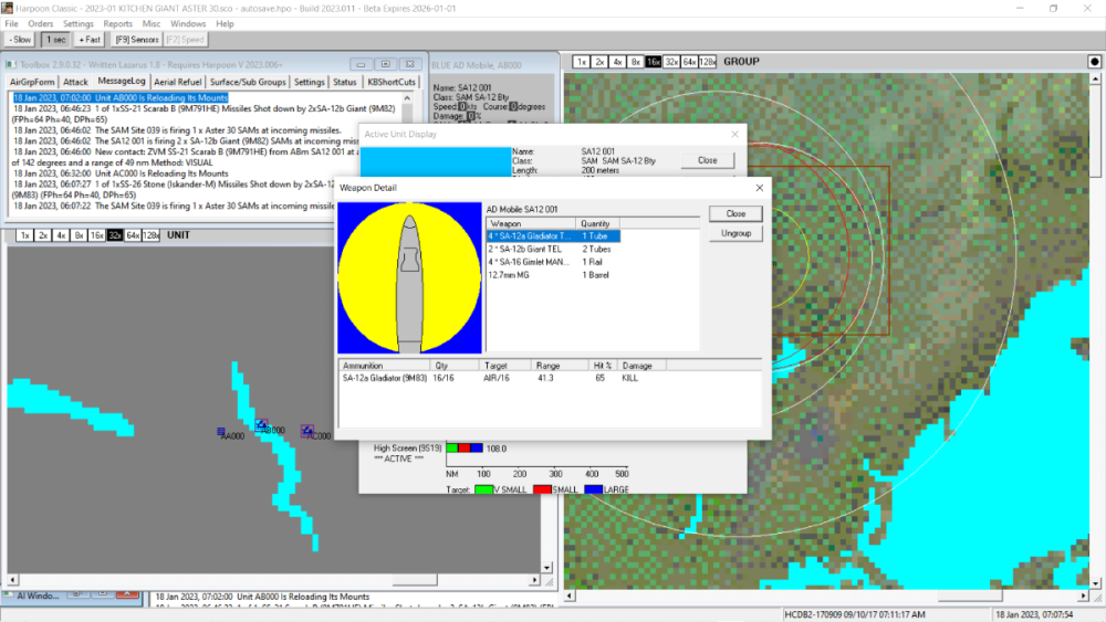

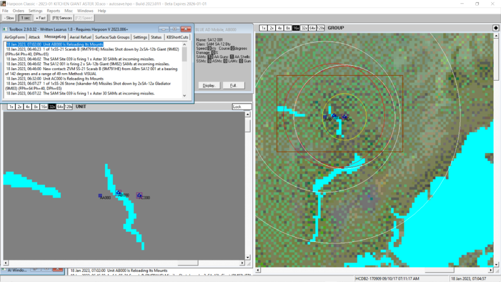

also, as a related issue, I see many mounts (now testing land-based SAMs, but also ship-based gun mounts) are not reloading its mounts, even with the correct magazine loads.
5 hours ago, broncepulido said:
As example this test scenario, SA-12 and ASTER 30 batteries don't reload its mounts:

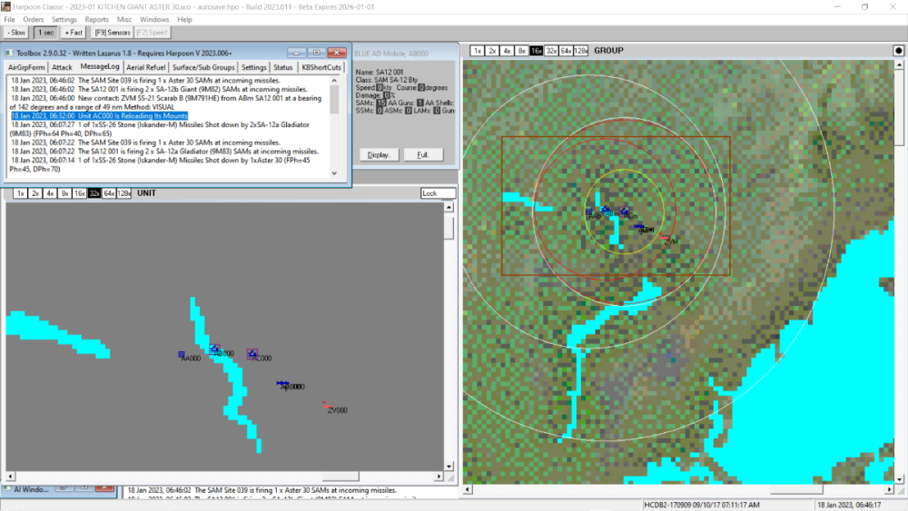

running std hcdb2 170909 I get mounts reloading:
image.thumb.png.c206d9d63fac8fb2e9d5e03de50e7eaa.pngimage.thumb.png.f85477a6c0ff91712d1bfc2c61d3b75d.pngimage.thumb.png.9345e93956e3250e0c181be3e03c9c37.png
and the mounts are now replenished.
Maybe check if your database when loaded in game has correct magazine. I use either my Toolbox or AIWindow, in toolbox look under surface/sub groups page and select the group then the unit to get unit info including magazine, in AIWindow look under Startgroup page and select group then unit. I don't know any other way of checking in game magazine.

I'm thinking at the moment that the error is in export from PE to commondb, so in the PE the magazine can look good but in the commondb that the GE links to it can be bad. This is what I've seen in a couple of mine that are edited in PE then new commondb file generated by export, and you can't see the error in GE (without extra help from eg toolbox).
It does seem to be a tricky customer this one :D

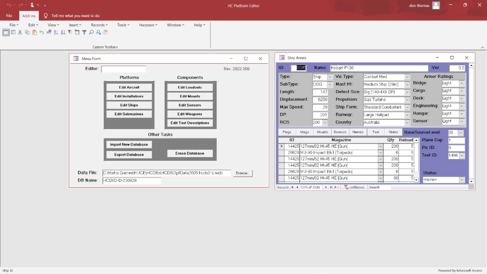

This is the PE view of magazine for my Hobart F100s, but one export of the database had the magazine corrupted, yet another export of the database and the new (in theory identical I believe) database is good (for Hobart F100). I don't know what is happening
Ugh, so not deterministic, that's going to complicate things.  Can you type out your steps so that someone can try to reproduce?
I will, and redo the whole thing to be certain.
YAY, I don't know what I did before but the error seems reproduceable on a second run.
But I started from a bad commondb file, so I'll run it all again starting with a good one.
I have the commondb.res file in base folder and run ge with a simple test scenario with a known bad ship.
I import into a PFData file and the mag looked good, I exported with no changes and the bad mag is still showing up in th egame.
I'm completely baffled. If I start with a commondb.res file that plays in the game with a bad magazine showing up in toolbox and import it into PE it looks good, I export it and in GE it still looks bad, commondb .res file seems to have been updated by time stamp.
If I do the exact things with a commondb file that plays good in GE showing up correct magazine in toolbox, importing into PE it still looks good and exporting to commondb.res it still plays in GE with correct magazine?

There is a minor (I think ) error in the mag for RAN Adelaide (07) class, the 12.7mm MG rounds are still there although the MGs mounts have been removed. So I reoved the mg rounds from the magazine and exported to new commondb.res file, but in GE they were still there? So I threw out everything but two weapons from the magazine, exported and guess what, now there are two weapons only in the mag, but not the correct two. Screen shots attached.
Maybe it's not the export function that's in error, maybe it's the editing within PE?
and sometimes in GE the name has changed with the new DB, but no amendments were made to the names?
Sometimes it's Newcastle, sometimes Melbourne
