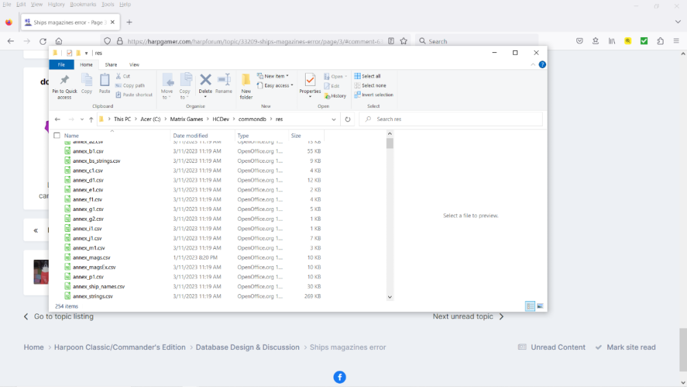

Another tool at your disposal is looking at the commondb\res\annex_mags.csv to see if it is staying the same across exports.
That'll be incredibly useful TE, this thing is very strange to me but I admit the PE is not my home turf. I did squizz into the folder but got overawed and departed.
I assume its written at time of export, not real time as edits are done in pe.
Correct, at time of export?
I've had a quick look, and don't really know what I'm seeing, the first ~85 entries look the same or nearly the same. Also what is annex_magsEx.csv, how's it differ. This is what I see, what is it telling me?

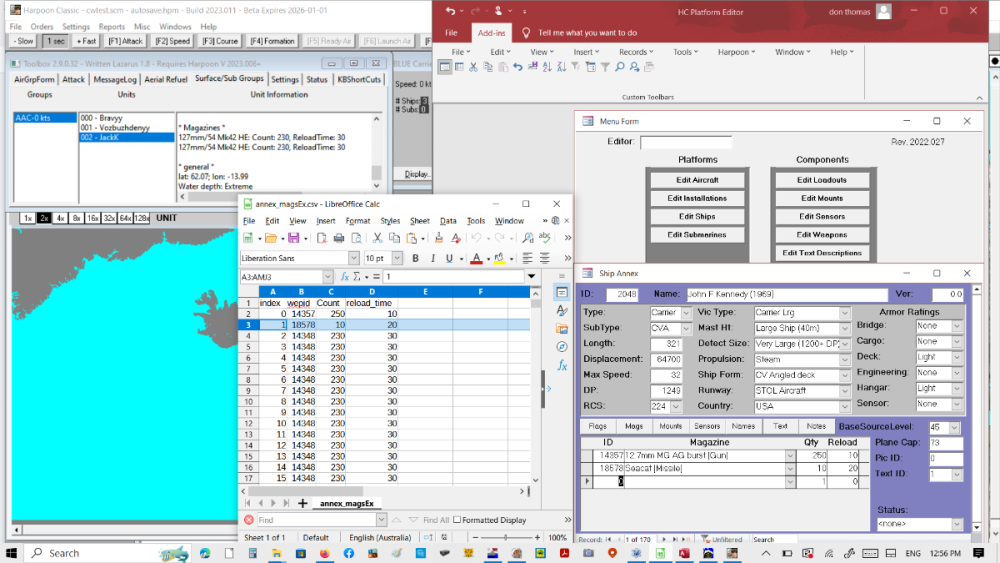

Trying for some basic info, I've started with HCCW110114, first ship (makes it easier) is '69 JFK CVA. It has no magazine to start and I add in PE 12.7mm AG MG. That comes thru in the first item of the csv file exactly as I entered it (assuming the wep ID is correct). In GE it's like some typo and I get 127/54 shells?
Checking the wep ID for the 127mm/54 is 14348, close but not very close to 14357 (what it should be).
Next I add seacat to the magazine, the csv file shows the addition correctly in the following line to the 12.7 mg. In the GE the mag shows there are two items but both are identical (and still the incorrect shell).

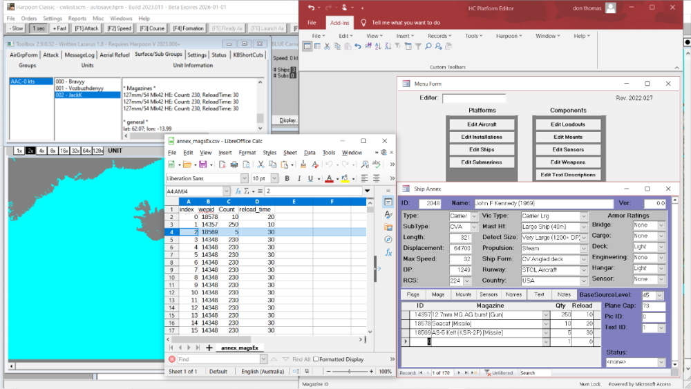

I've now added an AS-5 Kelt, and note a few things. Its seems to be added correctly to the csv file but the order of items has changed, The new item is after the previous two but the previous two are swapped around now in reverse order to how they are in the PE. In the GE three items but still the 127mm shells.

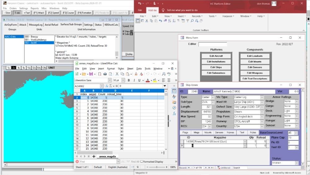

I've now deleted the first mag entry in PE, the 12.7 mg (original entry). csv file looks totally correct even same order, GE has correct number of items but still wrong item.
Now in the PE I deleted all items and added 25mm mg, good in csv but in GE it is retaining the 127mm shell.

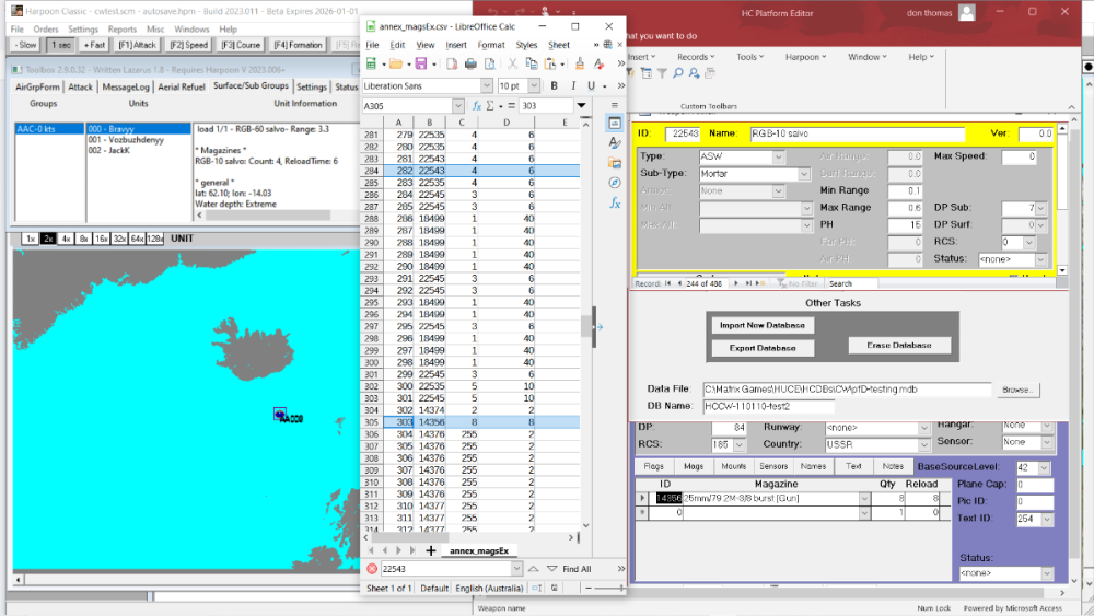

I went back to Katlin k/1, cleared mag and added 25mm cannon. Good in csv (item 303) but in GE get RGB-10, wep id 22543, which doesn't seem to appear in a ship class anywhere near Katlin k1. So no 'rule'.
