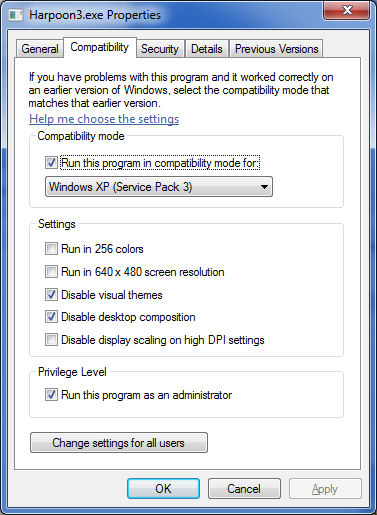

March 10, 201214 yr Two more approaches you can try while waiting for Russell: 1. Edit harpoon3.ini and change the line MouseSpeed=1 to MouseSpeed=1024 . Save the file then try the game. If it works, you can keep adjusting the value until it works in a way you like. Smaller numbers mean faster mouse. Usually a value of 1 or 2 is optimal. 2. Run the game with as little display hardware acceleration as possible. a. Switch to a basic Windows Theme, see b. Set the properties of the harpoon3.exe to match the attached screenshot.

March 10, 201214 yr Finally the mouse is functioning!!!!! Thanks Tony for your useful advise! <_> Frans Oh, what part helped? Congrats!
March 10, 201214 yr Finally the mouse is functioning!!!!! Thanks Tony for your useful advise! Frans Oh, what part helped? Congrats! The settings of the .exe files
