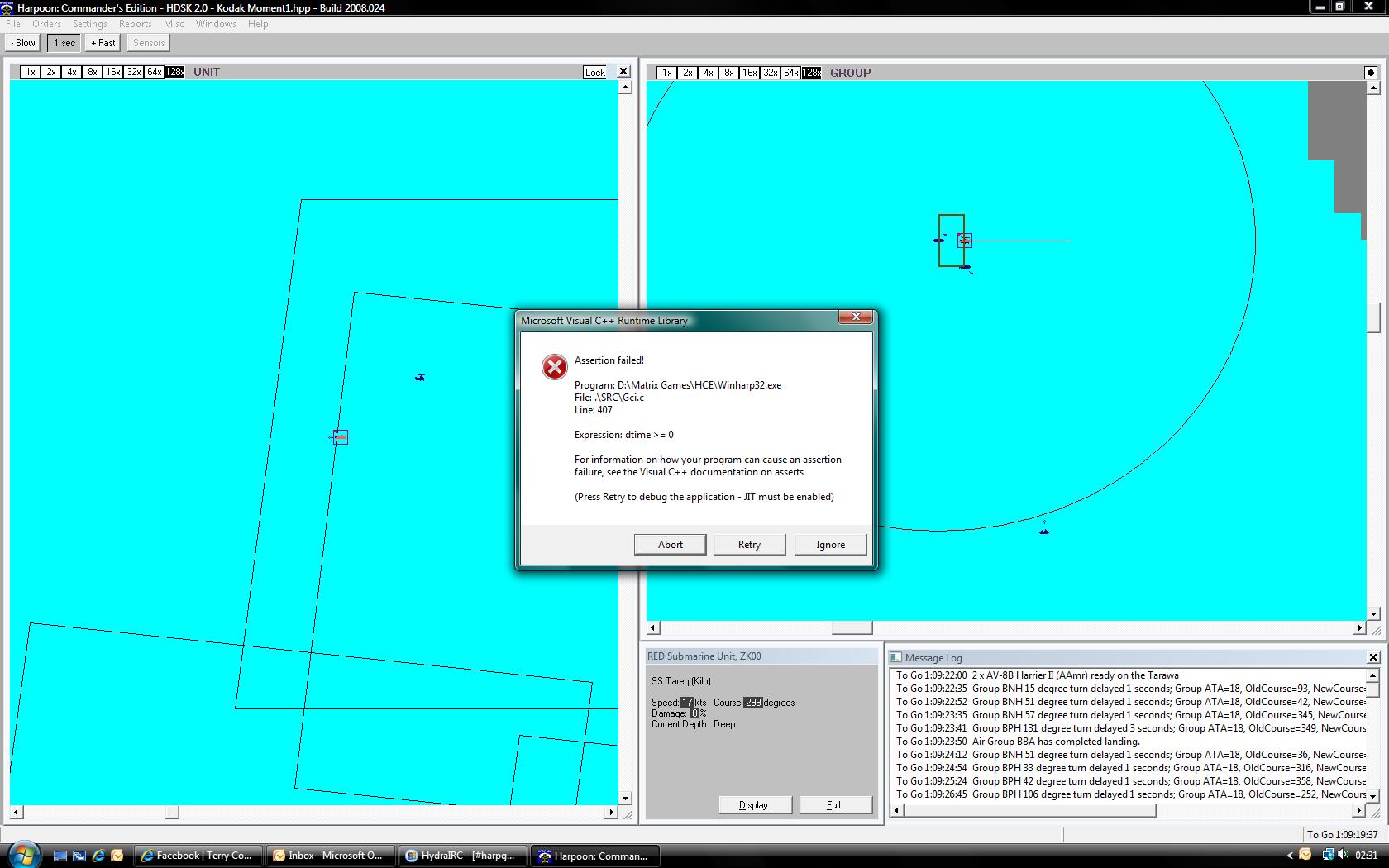

  12. Defect Name: C++ error recieved on resolve torpedo attack vs sub Build: HCE 2008.24 Repeatable: Yes Operating System: Windows Vista Ultimate x64 DB used: Stock DB Scenario used: Kodak Moment Battleset: EC2003 IOPG Long Description: An air launched torpedo in the save attached to this report is causing a C++ error during the resolution of its attack on a Kilo class submarine. The displayed error message will allow continuation of the game by clicking *ignore* Process: - Open GE - Open the attached save for EC2003 IOPG Kodak Moment - Watch the torpedo attempt to resolve its attack on the Kilo class submarine - After a few moments the game will stop and the error message will be displayed. - Note that clicking any other option than *ignore* will cause the game to CTD Expected Behaviour: Torpedo resolves its attack against the submarine and either misses or hits with interuption to the game client. Exhibited Behaviour: Torpedo resolves its attack against the submarine and gets interupted by an error before completion. Workaround: When this error is displayed during the resolution of the attack, be sure to click *ignore* or the game will crash. Notes: I am yet to test this in the current Beta, but will be doing so in the next day or two. I can see no evidence of this error being looked at or repaired in the change logs and I can find no evidence of past reports on this matter, so I expect the results to be the same. Kodak_Moment1error.zip
