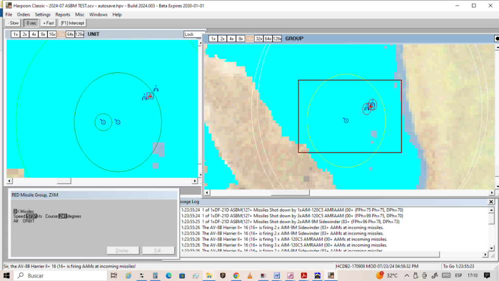

July 23, 20242 yr As consequence of the great and recent "Coral Sea 25" I did observe a little strange behaviour. To analyse it I scripted a little ASBM (anti-ship ballistic missile) scenario, settled in The Middle East IOPG theatre (Red Sea). Basically the problem is, when launched ASBM against the USN surface group, the Burke-class DDG correctly launches only SM-3 against the incoming orbital missiles, as they are capable of shooting down incoming missiles at orbit height, but not the SM-6 or SM-2, as its maximum ceiling is Very High. But the Harriers are launching against the incoming missiles its AMRAAM and Sidewinder, uncapable to reach orbit height!!! (only High or Very High capable). Also, I observe the AMRAAM and Sidewinder, inmediatly after his launching, dissapear of the screen (probably because are incapable to sustain orbit height!), but are inutily expended!!! 2024-07 ASBM TEST.zip
July 23, 20242 yr Author Both AMRAAM and Sidewinder launched at incoming DF-21D ASBM inmediatly dissapear (two or probably only one second after launching), no trace of its activity or failed impact on the Message Log window:
July 23, 20242 yr Author But not! The AMRAAM and Sidewinder are shooting down ASBM in ORBIT in the latest test. In other cases very probably the Harriers were in bad position to catch the ASBM with its missiles, because speed/aspect issues. Clearly showed in the Message Log window (test scenario changed to put Harriers in better interception position):
July 24, 20242 yr I noticed the firing of of aam against the orbiting missles in the same scenario but didn't think of the error it indicated or analyse like you have enrique. In fact I just packed my cargo planes and cleared out. Confirming that behaviour here same as OP using its attached scenario. You need to launch your harrier immediately and get all radars on. For me Harrier radar do not pick up the missile, ship radar does, and unless you manually conduct the intercepting fire of AAM the harriers (use F1 attack command) will not engage. interesting 5 of 6 aim-120 hit mark, 0 of 5 sm-3 hit mark. I was too slow to get a chance to fire sidewinder. Edited July 25, 20242 yr by donaldseadog report running the test scenario
