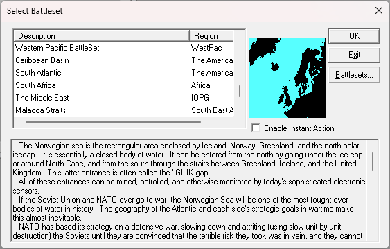

Tiper Posted December 12, 2023 Report Posted December 12, 2023 I bought the game and it came with multiple versions of Harpoon. The Commander Edition I load up there is no scenarios that I can find on my computer that came with it. What am I missing here? Thank you. Quote
TonyE Posted December 12, 2023 Report Posted December 12, 2023 Welcome, if the game is taking you automatically into a scenario, go to File\New then answer Yes to quitting your current game. You should then see the list of BattleSets when you choose one of those (a few of them do not have built in scenarios, give Western Pacific BattleSet a try) and click OK. At that point you should be shown a list of the built-in scenarios for that BattleSet. Does that help? Quote
Tiper Posted December 13, 2023 Author Report Posted December 13, 2023 TonyE Thank you. I figured this out now. I downloaded the scenario China in the Horn, late October 2023. Hypothetical historical scenario. It is a .scv file. The game is looking for a .sc6 file. How do I play this? Thank you. Quote
TonyE Posted December 13, 2023 Report Posted December 13, 2023 Here is a very old tutorial video that may help, https://youtu.be/4yHAXxGep6w?si=FyQvmnKJc6Tx3mIe .SCv indicates the Middle East BattleSet Understanding HC/HCE File Names - Frequently Asked Questions (FAQ) - HarpGamer For "China in the Horn" you will also need to grab the HCDB2 database. HCDB2-170909 (1980-2025) - Databases - HarpGamer You picked a challenging start in terms of game setup ;). It is entirely too difficult to load scenarios that don't come with the game, making it easier is one thing on a very long list of things to improve. Quote
Tiper Posted December 13, 2023 Author Report Posted December 13, 2023 TonyE : Thank you seems like I missed a few steps on this. The You tube video explains a lot. I really appreciate the help. Have a good Holiday. Quote
