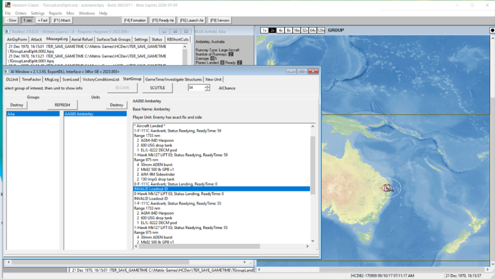

Landing is incomplete and 1 Hawk and 2 Aardvark remain in loiter/landing state until they run dry of fuel.
The landed aircraft include two mysterious units consisting of zero ac and two normal units comprising the landed Hawk and Aardvark.

I modified code in AIWindow to check if landed AC had valid loadouts and the "Ghost" landed aircraft (after landing a group with splitoff then rejoined AC) have invalid loadouts. If that helps?

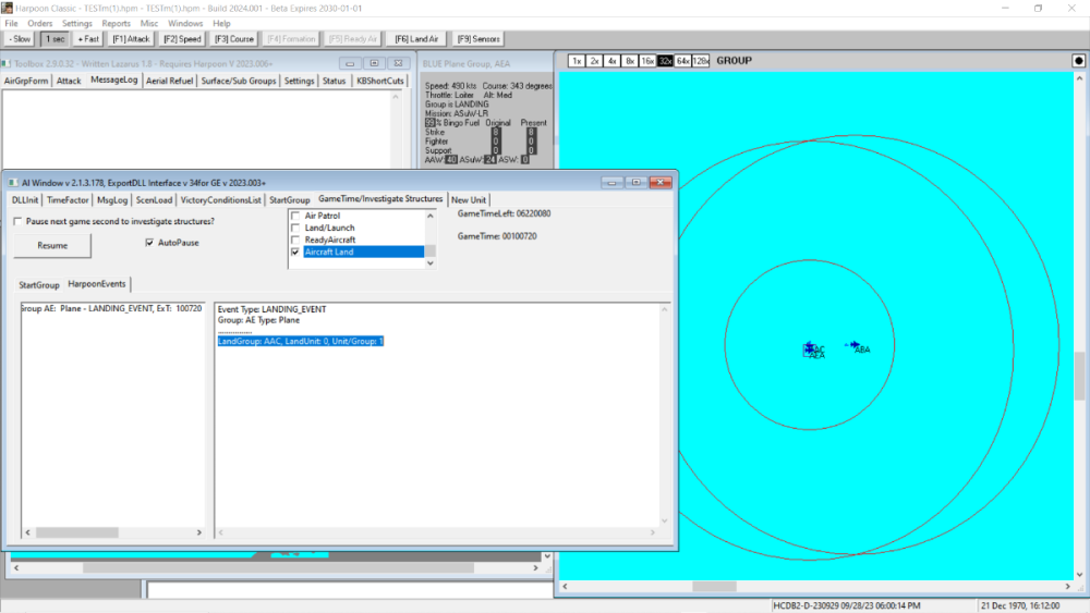

I added landAirEvent to my catchers mitt in AIWindow, it doesn't seem to have as much info as I'd thought it would thinking about otherevents like Join and Split. I was a bit after my brain's 8.30 curfew so another run tonight and I might gleen more out of it, but I didn't see anything differing between the working air groups and the disfunctionals. Looking at what I see I assume when a land order is given (either from within course edit or raw from the game play) that the course is edited to put a leg to the landing point and the landairevent at that point.
the landair event seems to indicate if it's the whole group to land or if it's a unit of the group (so far only seen this if the landing unit is a patrol in a group eg carrier group). when the whole group it gives no info on the units or their structure. What seems to happen is that not all units land but also one ac from at least some of those units does land.

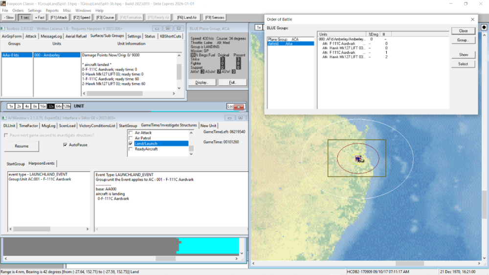

Another thing is that the receiving unit (base unit) seems to get a plane entry allocation but with no ac in the plane, ther will be one of these (usually) for each unit that is hng up without landing clearance. So I'm guessing some of the landing processing is occuring?

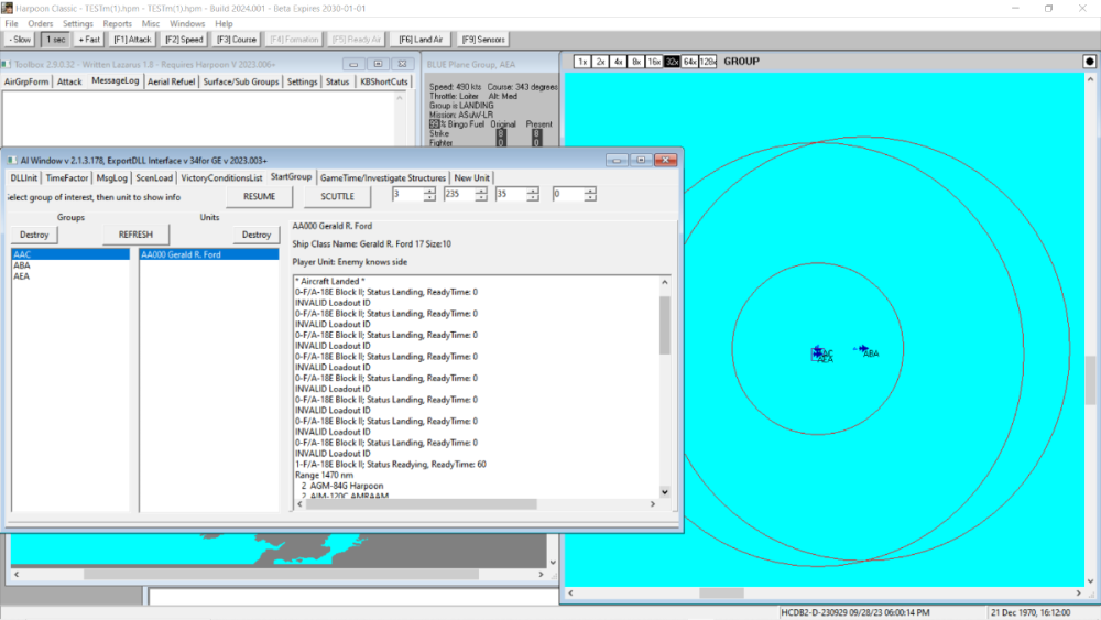

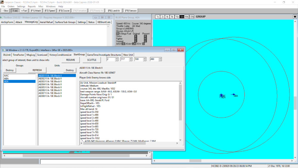

I ran TD's TESTm.hpm in 2024.001 with my AIWindow addon caputring the moment that the group AEA's landairevent triggers. AEA consisted of 9 units each a single ac. Sceenshots attached respectively show the group now consist of 8 units (unit 00 not there) (leaving the game run no more land), the event data for the landairevent that to me only indicates that the whole group is to land on unit 00 of group AAC, and the interesting info for the base carrier that there is a single landed f/a 18 (60 min ready time) and 8 zero ac planes - so the code here is listing down thru the carrier PHCUnit^.MyPlanes. To me some of the landing process for the remaining 8 units has occured but not completed? I'll keep lookiing to see if I can glean out info more useful.

An interesting aside, you can join (F7) the carrier group AAC to some of the stranded units of air group AEA and one (sometimes but not always more than one) will then go thru normal landing. If join two units then only one lands and the second is stranded as an inflight air unit of the carrier group. That stranded unit can be split from the carrier group and sent to land F6 in the normal manner and it lands normally.

I think the LandAirEvent triggers during  xxx.0005 or next second of play for xx.0004. At that point there are two units remaining in AEA, one unit landed and readying and two zero aircraft PHUnit^.MyPlanes listed for AAC.
