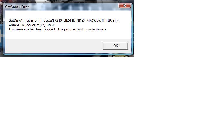

I'm receiving the attached error with 2008.060 when I try to run any scenario in the WestPac BS except the 2ND and 3RD scenarios. Repeatedly clearing the error eventually clears it and allows normal play.
Buddha
Buddha
Are you by chance running a customized database? Maybe I should ask which DB and version you are using. I'm not able to replicate the problem here using HCDB-080824.
Buddha
The PE reports DB as HCDA-080924. I haven't done any customizations on it.
Buddha
Buddha
Wrong DB. The HCDA (HC Database Americas) is not for the Westpac battleset.
Buddha
Brad,
That was it, thanx. I still occasionally get the DB's misaligned somehow.
Buddha
