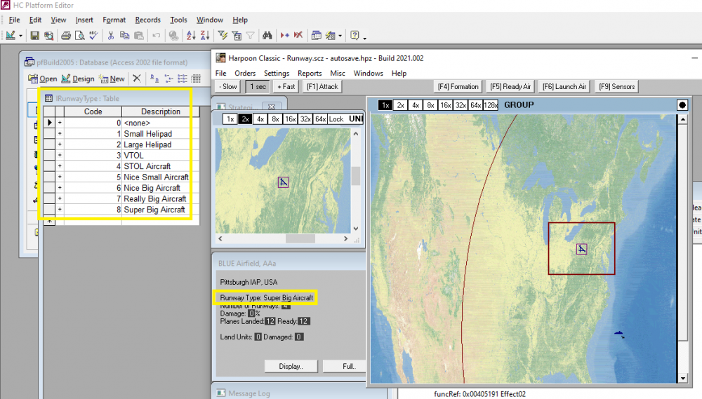

Completed today unless I find any last-minute bugs.  Note that this is the ninth runway size indicating that more than 8 work.  You can have as many as 128 runway sizes.  No runway can be damaged beyond the 4th smallest size by hard-coded game rule.  That has traditionally been the STOL runway size.
Great effort Tony, thanks! Also we need a clear reference about the runways lengths in meters or feet.
Allrighty, 2021.002 posted!  Broncepulido, your comment does trigger me to mention that I fully expect long runway length names to result in some buffer overflow errors.  I'll hopefully squash them for 2021.003.  It is up to the DB author to include the length in the runway size name if they so desire.

Hmm, actually hard to believe but it looks like all of the buffers were long enough to handle the increase from 16 to 32 character max length of runway size descriptions.  2021.002 should be good in that regard!
