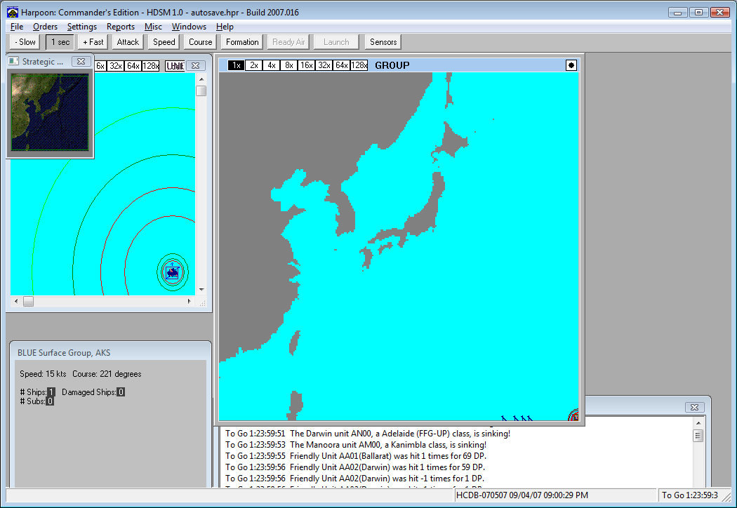

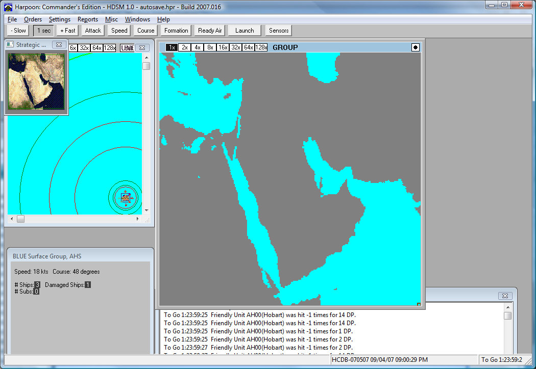

September 11, 200719 yr 1. Allow one or more additional range bins in the formation editor and increase the maximum range in the formation editor from the current 255 nm. 2. Add a Mid-East battleset - suggest 20° E to 70° E Long by 10° N to 40° N latitude. This would provide one battleset as opposed to the current split of the volatile MidEast into two battlesets. 3. Add a smaller WestPac battleset that would be more playable - suggest 110° E to 160° E Longitude by 15° N to 50° N Latitude. 4. Allow the time of day for the scenario to start, to be set either at start up or in the scenario editor. It would also be nice to have some sort of progress bar to show the current day night situation. 5. Do something to change the shade of the red symbols. I like to use the textured maps, but the red symbols are very difficult to see against some backgrounds, even when you know they are there. 6. Allow for damaged bases to be repaired. 7. Allow for the capture and use of enemy bases. 8. Allow refueling groups to be assigned to intercept the groups they will refuel and join up and refuel automatically. Note that refueling aircraft are often slower that the aircraft that will be re-fueled. Often they will start out, while the aircraft to be refueled are on the outgoing leg. The logic will have to allow them to deal with that fact in this situation. In other words they will never intercept until their target flight starts back. 9. I don't know the situation regarding aircraft guns. In the early days aircraft would attack using guns, but I haven't seen that happening in years. It would be nice to bring them back. 10. For aircraft groups it would be desireable to temporarily disable long range missiles. Often a group on CAP may come upon an enemy group with little missile capabilities. In this case it would be desireable to attack using short range missiles and preserve the long range missiles for a later target. It can be done by manually flying an intercept and only issuing an attack order when very close, but this is very tedious.

September 14, 200719 yr Map screencaps of the coordinates provided by Smitty Makes me want to get the textured maps working with the BSBuilder...

September 15, 200719 yr Do you not life Australia or something? Nearly every screenshot you show has Aussie ships being blown apart. , I rather like Australia, haven't been there yet but I hear good things, and some very good looking actresses! For most of the screenshots yesterday I used a WestPac scenario with Australian units. When they don't have a spot within the current map they all bunch up in one spot and as you've seen, take some nasty hits. ,I'll try to pick on some other country next time... At least I didn't say Austrian units, go Bush!
