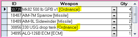

Actually there is an ordnance flag in the Weapons annex, could be a hint,
this is a F/A-18 on a precision run:
Would jettison the Mk82 and the drop tank when cornered.
Hmm, could be tricky with the tank though, would jettison need to modify the range of the a/c? Or perhaps we may assume that the feed order ensured that the external tank was used fist.
Khm, also an AS-4 under the belly of a Tu-95 is not ordnance.
Ok, the point is that AAMs are not jettisoned.
