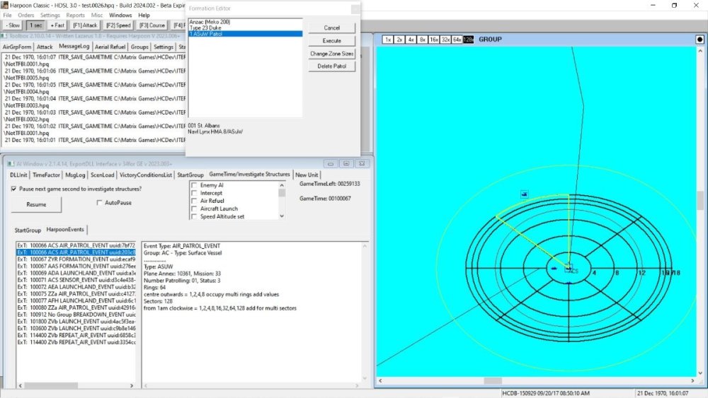

Using my AIWindow tool I found a formation patrol event for SG ACS that is corrupt with an out of range value for 'Rings'- see screen shot
by deleting the patrol before the 1.20 time the game will continue. I reproduced the problem by setting up a patrol and 'clicking' near the very edge of the rings to obtain a patrol that is yellowed as a complete 'pie' sector including the centre 'main body' (which should never occur).

Confirmed here in 2024.002.  Thanks for the older issue reference, that helped me skip right to the function in play, MoveAndSetPosition in formedit.c.  It is not a regression from the previous fix, rather a new case with the same end result.  I don't have a fix yet but have a strategy to further debug via a bunch of logging statements.  Debugging isn't super straightforward since if I set breakpoints that is going to result in more windows messages which will prevent the code from acting naturally so it is a case here of log, recreate issue, review logs, tweak code, repeat...
formedit.c FramePatrolRegion tries to figure out what ring is selected and in this crash case it identifies a ring one beyond what the UI shows which leads to the experienced nastiness.  No fix yet.
I have a fix that I'm so far testing successfully.  Have I mentioned how much I hate the ancient user interface code?!?
I'm finally fixing a forever old piece of formation-keeping code that has logic that would occasionally infinitely loop.  It is the code that when a formation patrol is assigned to multiple rings and/or sectors must decide which individual formation spot to go to at that time so not a common use-case but happened to hit when I was testing the crash fix and I finally am conquering.
