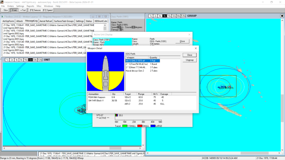

Restrict yourself to ship vs ship. Compare say a single barrel single turret gun  and single rail single mount missile launcher. EG 4.5" gun and mk 13 GMLS ( a late mod RAN Perth class I think has both, the mk 13 including harpoon in the mount magazine
image.thumb.png.ef43b3b8f31013b85ebcfc018202deff.png).
Say you have two targets or just want to throw plenty of metal. With the gun it works correctly, you can only fire one shell at a time and further allocated shells are fired at intervals (according to mount rate of fire), but with the missile launcher you can fire as many at once as you have on hand in the mount.
Just for run I loaded the mk 13 magazine with 40 harpoon and blew the autralian munitions budget to bits with a single firing of all 40 (from the one arm bandit) :D

But not remember if was that limitation on the ship missile launchers against surface targets (using Standard as SAM, the number of missiles is limited by the number of targets the mount can engage, and the total number of missiles the mount can launch, as showed in this picture:

Thanks Enrique, that's what I thought.
In next couple days I'll put in a report post.
I really only noticed this as I was looking at ways of overcoming the loss of reliable ship magazine for those of us that write our own database (or modify for our own use) and had thought of just adding weapons to the mount magazine but it got a bit silly.
