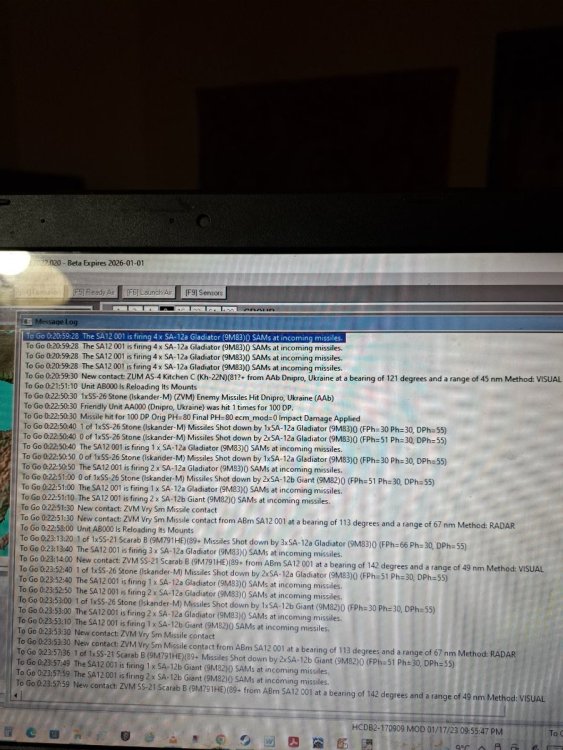

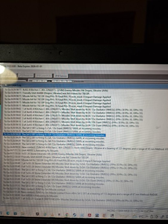

January 17, 20233 yr I wonder if someone might do me a favour and set up a test scenario that pits S-300V (SA-12) against the Kh-22 (AS-4). Run it a few times and let me know how often the S-300V is successful in shooting down the Kh-22.
January 17, 20233 yr Author I ran a test scenario in Command. A single Kh-22NA (NATO AS-4 Kitchen B Mod 3) was launched from a Tu-22M3 (NATO Backfire C) at near maximum range. The target was an industrial plant in Dnipro, Ukraine. A single Ukrainian S-300V1 (NATO SA-12) SAM battery was set up near the target. The S-300V1 began engagement (with 2x 9M83 missiles) when the Kh-22NA was at about 16 nm from the target, and descending below about 28,000 feet. The Kh-22NA was intercepted with 1x 9M83 SAM at about 9.7 nm from the target, while moving at 1499 kt and at 17,330 feet. I thought the scenario was interesting given the recent tragic Kh-22 strike in Dnipro and the widespread claims (by Ukraine and others) that Ukraine has no capability to defend against Kh-22. I didn't think that sounded technically correct, given that Ukraine does possess the S-300V1 and it was designed to defend against such weapons as Lance, Pershing and SRAM. The Kh-22 is certainly a challenging target, but the S-300V1 is at least technically capable of defending against it. (On "paper" or in a sim like this, of course. Caveats apply.) Still interested in what you might find in HCE.
January 18, 20233 yr Author Thanks, Enrique. I see you tried a mix of weapons, and S-300V was more or less capable of intercepting all of them.
