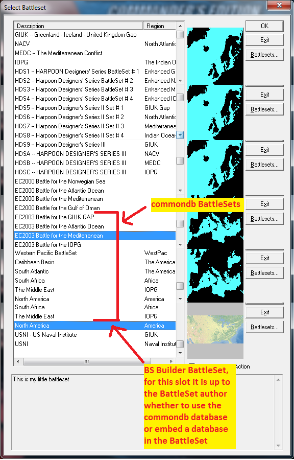

August 24, 20197 yr new codename/package label: commondb BattleSet - a BattleSet that uses the commondb.res and commondb.rsr files. A non-commondb BattleSet has the platform database information embedded in the BattleSet files and is not affected by swapping out the commondb files. As you can see from the screenshot below, there are far more non-commondb BattleSets than commondb but the bulk of the user-submitted scenarios are in the commondb BattleSets since the commondb/user-editable database brings so much more to the table in terms of making use of the game's functionality. An acronym list https://harpgamer.com/harpforum/topic/2082-hc-acronyms/ Information on leveraging user scenarios plus a link to understanding scenario and saved game filenames https://harpgamer.com/harpforum/topic/13353-user-scenarios-and-custom-databases/ BattleSets information https://harpgamer.com/harpforum/topic/11347-battlesets/ (textual view of the graphic below)
