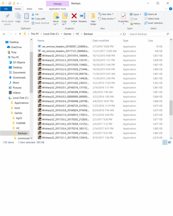

August 20, 20197 yr A reinstall wasn't necessary but I understand the haste. The process could be easier. It is only the database update that makes the original scenarios (specifically only those in the EC2003 and new BattleSets) unplayable. A copy of the original database is in the commondb.bak subdirectory of the game (so by default C:\Matrix Games\HUCE\commondb.bak\commondb.res) so the backup is already made for you. The beta installers also make backups of the files it replaces, they can be found in the Backups subdirectory of your game (screenshot of mine attached).
August 21, 20197 yr Author okay thanks - though i looked in my backups folder and none of the files like you show here were in mine - all very strange. so i guess i would just like to know from what folder should i run the beta updates and db update?
