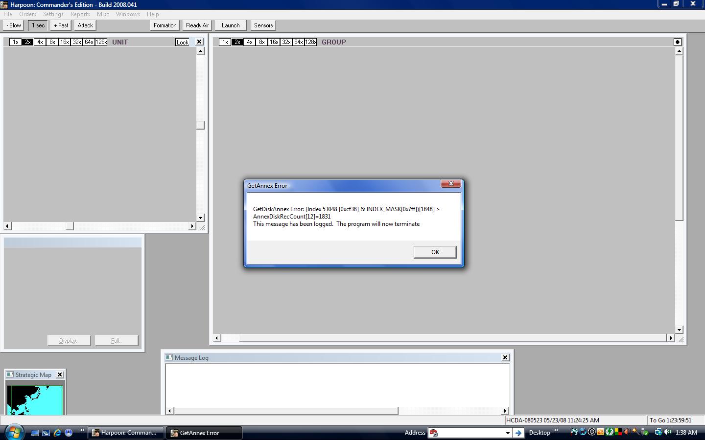

Since installing the latest Beta, I get the attached error message in the WestPac BS when loading scenarios 4.0 and above. Although the message states that the program will terminate, clearing the error repeatedly (anywhere between 3 and 9 times so far) will finally allow the scenario to be played normally.

Seems to be an error loading the db...
The Installation 53048 looks ok...

In your screenshot you have the HCDA database loaded, not HCDB. I just checked the zip file and it had HCDB in it so you probably just need to swap in the right database, http://harpgamer.com/harpforum/index.php?a...mp;showfile=235
I did include the wrong MEDC 2003 Battleset and will remedy that in the next build.

Tony,
That seems to have solved that problem, thanx. I don't know how I got the wrong DB in there, but with all the switching I do sometimes, it's not a surprise.
One thing, though. I previously created a Caribbean Sea scenario using a BS I made with the BS Builder. When I load that scenario now, Elgin AFB lists itself as being in Baghdad instead of the Southern US. It's still in the same place, and the A/C are still the same, only the name has changed. Also, the HCDB seems to have no US Facilities in the Caribbean region. Is it safe to assume that maintainig separate commondb.res files in separate folders and swapping them as needed will be OK?

Your method of swapping should be fine. You do have an alternative in recent builds, when you create that custom battleset you can now embed the database in the hdsu.res and hdsu.rsr files. In the BS Builder you'll see a new tab that mentions database (so there are map, BS description, scenario, and database tabs these days). Embedding the database simplifies things greatly, especially when releasing to the general public as they don't have to match scenarios to battlesets and databases to battlesets, everything is included in those two files, hdsu.res and .rsr.
I've found myself making a folder for each custom battleset I make. I store the .HCBS file, scenarios (including orders), and database files used in the folder so that I can quickly re-build the battleset if I want to update the embedded DB or scenarios.
