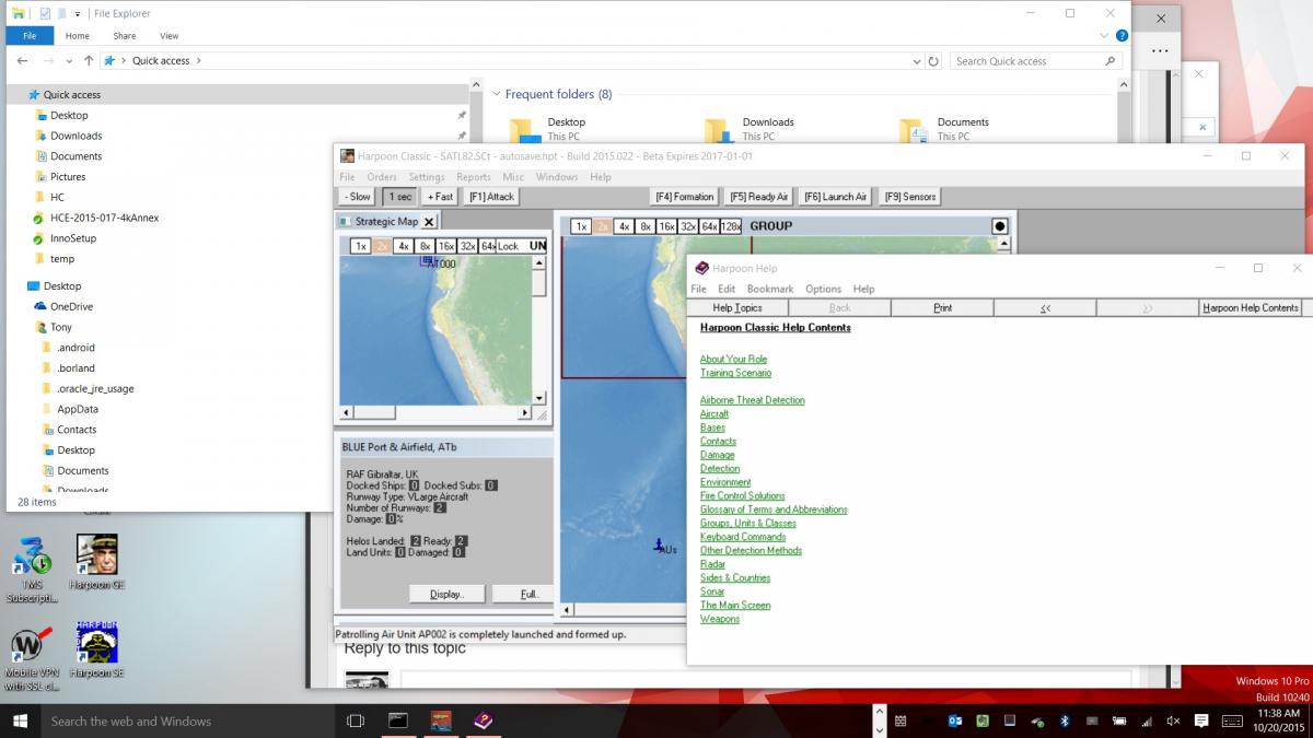

TonyE Posted October 20, 2015 Report Share Posted October 20, 2015 I spoke too soon again I see. The Help system for Harpoon doesn't work with Windows 10. I went through this when I first got Vista, and MS had a fix for it. Now the MS Site has fixes for Win 7 and 8, but nothing for Win 10. Any suggestions anyone? Thanx, Buddha First I would suggest not bothering since those help files are even more horribly out of date than the PDF manuals. If one insists on making WinHelp work, here is what I did: 1. Downloaded the Windows 8.1 x64 https://www.microsoft.com/en-us/download/confirmation.aspx?id=47671 2. Moved the downloaded .msu file to a temporary location 3. Started a command prompt as Administrator 4. navigated to the temporary location via command prompt window 5. Created a HelpViewer directory and within that an Extract directory 6. Ran expand -F:* Windows8.1-KB917607-x64.msu C:\Temp\HelpViewer 7. Ran expand -F:* Windows8.1-KB917607-x64.cab C:\temp\HelpViewer\Extract 8. Now you have the contents of the installer extracted. 9. I fished out the winhlp32.exe file and winhlp32.exe.mui for my US English installation and copied them to C:\Temp 10. Went to http://www.komeil.com/blog/windows-help-program-winhelp-winhlp32-exeand downloaded the associated file. 11. Extracted install.cmd from the associated file in step 10. 12. Edited install.cmd, at the tail end of the settings section added: set WindowsVersion=7 goto :BypassVersionError 13. Ran install.cmd as Administrator and voila, WinHelp works in Windows 10 x64. 14. The install.cmd file also makes a couple of registry changes that allow opening the help files over a network connection. You could also trust the entire file from komeil.com, I chose to trust the files from Microsoft instead. Quote Link to comment Share on other sites More sharing options...
TonyE Posted October 20, 2015 Report Share Posted October 20, 2015 A little suggestion of proof Quote Link to comment Share on other sites More sharing options...

TEPonta Posted October 23, 2015 Report Share Posted October 23, 2015 Finally got around to trying it. Works like a champ Tony, thanx. I really wish MS would leave some of these things alone, and I could sure do without all the UAC/Administrator hassles. Nobody uses this system but me, and even if someone else in the family used it, I wouldn;t need all the headaches. Quote Link to comment Share on other sites More sharing options...
