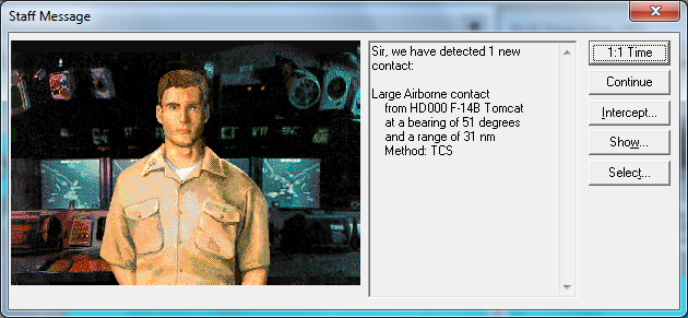

July 3, 201313 yr As for our original goal with this topic, I just had a first time, TCS is working! F-14Bs flying CAP have just picked out large contact among a flight of 4 Tu-16G Badgers, it must be the EW escort jamming the radars of the CAP!
July 4, 201313 yr As for our original goal with this topic, I just had a first time, TCS is working! F-14Bs flying CAP have just picked out large contact among a flight of 4 Tu-16G Badgers, it must be the EW escort jamming the radars of the CAP! TCS.png Excellent.

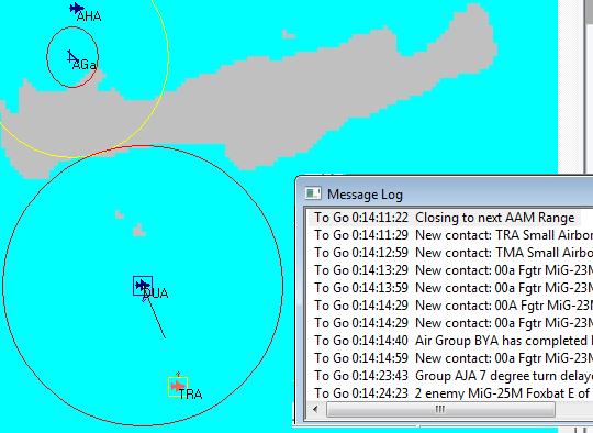

September 21, 201313 yr That's a first one too, or is it just me?> Closing to next AAM rangeVow! Where have you been all this time?? I order DUA to attack TRA, which judging from their cruise speed is a pair Fishbeds. DUA is already in AMRAAM range when I issue the order so weapon selection pops up, but I do not want to waste AMRAAMs on Fishbeds, so I ... I think I deallocated the AMRAAMs and then hit Cancel (?) or Execute (?).Lo and behold TRA logs "Closing to next AAM range" and vectors for TRA to attack with Sidewinders. Has this been introduced recently? I'm playing 2009.095. I was so much longing for this feature but this has never worked before. What did I do right this time? Have mercy, tell me!!

September 22, 201313 yr That's a first one too, or is it just me? > Closing to next AAM range Vow! Where have you been all this time?? I order DUA to attack TRA, which judging from their cruise speed is a pair Fishbeds. DUA is already in AMRAAM range when I issue the order so weapon selection pops up, but I do not want to waste AMRAAMs on Fishbeds, so I ... I think I deallocated the AMRAAMs and then hit Cancel (?) or Execute (?). Lo and behold TRA logs "Closing to next AAM range" and vectors for TRA to attack with Sidewinders. Has this been introduced recently? I'm playing 2009.095. I was so much longing for this feature but this has never worked before. What did I do right this time? Have mercy, tell me!! I'm sure i've seen this but only when I've tried to attack and nothing has happened, never figured out what triggers it so I don't know how to use it advantageously. Looking forward to to hearing more
September 22, 201313 yr I've seen this again (these were all playing HDS7 12.0).The feature triggers when you order an air group to attack an other which is already inside the range of the long shot AAMs of the attacking group. On both occasion the target group was on the very edge of the long AAM range. Probably it is also needed that the Moon has to be full, Jupiter should lie with Mars and some other yet unidentified celestial favors , other words, unfortunately it is not consistent. I got lucky, the second time the closing to next happened right after I saved but when I reload and attack again it is not triggered.It works as: I press [F1] Attack for my group with an enemy already inside long AAM range. Target list pops up with the closest enemy preselected and a soon as I accept pressing OK,before or simultaneously to the Weapon Selection popup opening the message "Closing to next AAM range" is displayed in the log window and a course is plotted for my group for an IR AAM range intercept the Weapon selection popup is still open at this time I logged an issue for it, this would be great to have consistently, the save file is attached in the issue report.
September 24, 201313 yr If you want to get a taste, I just got a save file where GE provides you with "Closing to next AAM range" consistently. (GE=2009.095) at 09:18:03 a pair of Mig-23s is preparing to take off from ZZa (radar ring appears) at 09:17:59 GFA detects them via ESM Close the SA popup and order GFA to attack ZZa GFA closes to next AAM range! - Weapon selection does not pop up as the Migs are still only Launching- close to next AAM is also triggered if you select Intercept on the New contact SA popup nextaamrange.zip
