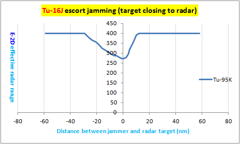

Tu-16J escort ECM (a.k.a. standoff jamming) of E-2D Hawkeye radar (EC2003 battleset)
The direct jamming test flight showed that the appearance of the yellow lightningbolt does not mean that the marked radar is "jammed" in general and in all directions. The jammer has to be (very) close to the radar or to the plane it wants to mask. I'm going to test now how far does the coverage of the Badger's ECM reach.
The Hawkeye is once again loiters over the Atlantic, our Badger some 270nm North of it, loitering too, ECM active. The Tu-95 Bear ELINT target will fly towards the Hawkeye from +400nm out on the axis of the Badger. The Bear will pass by the Badger as close as possible barring an accident.
index.php?app=core&module=attach&section
And here is the ELINT data.
  • The negative half of the X axis shows when the Bear is further out than the EW Badger, the positive half is when the Bear has passed the Badger and is between it and the Hawkeye.
  • This radial slice of the ECM "bubble" is asymmetric, stretches to -28nm away from the radar (back lobe) but only to +10nm towards the radar (main lobe). The escort bubble is also smaller than the direct bubble, remember the Badger's ECM range is 60nm. It can not be seen on the graph but the log shows that the jamming actually starts at 59nm from the Badger, but it has no practical effect that far from the ECM source, the radar burns through outside of the bubble.
  • The maximum ECM effect, that is the degradation of the radar range in this case is ~30%, the Bear closely escorted by the Badger would only be detected by the Hawkeye at 272nm instead of 400nm.
  • The escort ECM decreases the radar's effective range roughly with a proportion two times the fraction of ECM range to the radar's maximum range.
  • E.g. the Badger's ECM range of 60nm is 15% of the 400nm range of the radar, so escort jamming can reduce the max detection range by 30%.

Attached the test scenario and the data extract in excel, for the interested.
LOS.zip
