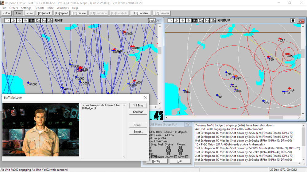

September 2, 20251 yr While running scenario, the GE crashed without warning multiple times. Attached are saved game files, GE and Message Log. Tried running without AI ToolBox. If more saved Game files are needed they are available. Same thing happened yesterday, but while trying to recreate the issue it stopped occurring. If you need any additional info or saved games, please let me know.. GE Crash HDS 9.zip

September 4, 2025Sep 4 Author The reason for the extra files is I have no clue what causes the clue, or when it actually happens in the game. Using the interactive saved games I have all the saved games if needed. I was attacking plane groups with air to air missiles. Using 2025.025 update today on my laptop, while attacking planes with both air to air missiles and guns the GE crashed. There is no warning the GE just closes. Even if I play from an older saved game somewhere along the way the GE closes without warning. It drives me crazy that I don't have any better info for you to investigate the issue. I tried playing without DonT's Ai box.and ToolBox. Both times the GE crashed today I was attacking the same bomber group. The Groups ID is Red group YdA a group of bombers and EW AC. Attached s today's GE crash. I was auto saving the game at 10 second intervals. YdA Attack GE Crash (2).zip
September 5, 2025Sep 5 I think this relates to the use of either toolbox or Lazgui-extn which both collect information on stores used and the seemingly automatic use of cannon by air group FuA attacking air group YdA. It's not a problem that has occurred before but then I've never seen the apparent automatic engage A2A with cannon. In the saved game YdA Attack etc this occurs at time 40:12. If before that you change the course of FuA to avaoid coming within 3 nm of YdA all is good, if you then steer FuA back on a collision course you get the crash. If you have neither toolbox nor Lazgui-extn operating there is no problem either.
September 5, 2025Sep 5 I've given eric some homework on this but I'm not home and forgot my power pack and now have no operational computer. What really strikes me as strange is that the blue air group seems to attack with cannon with no orders to do so. It's current course (which I checked and is an attack course) seems to me to indicate it is intercepting one of the ac groups to the NE. You can even cancel its course and give it an out and return to the vacinity of the red group and it will open fire with cannon with no instructions. Its a bit like a vessel with aa engaging automatically.
September 7, 2025Sep 7 In the legacy (non-commondb) BattleSets, certain aircraft (with certain loadouts like Intercept) are assigned 4 bursts of air to air cannon. If the planes when flying get close to enemy aircraft, they will attempt to dogfight all on their own and ideally shoot down the opponent. In other words, you are seeing exactly what the game is supposed to be doing.
