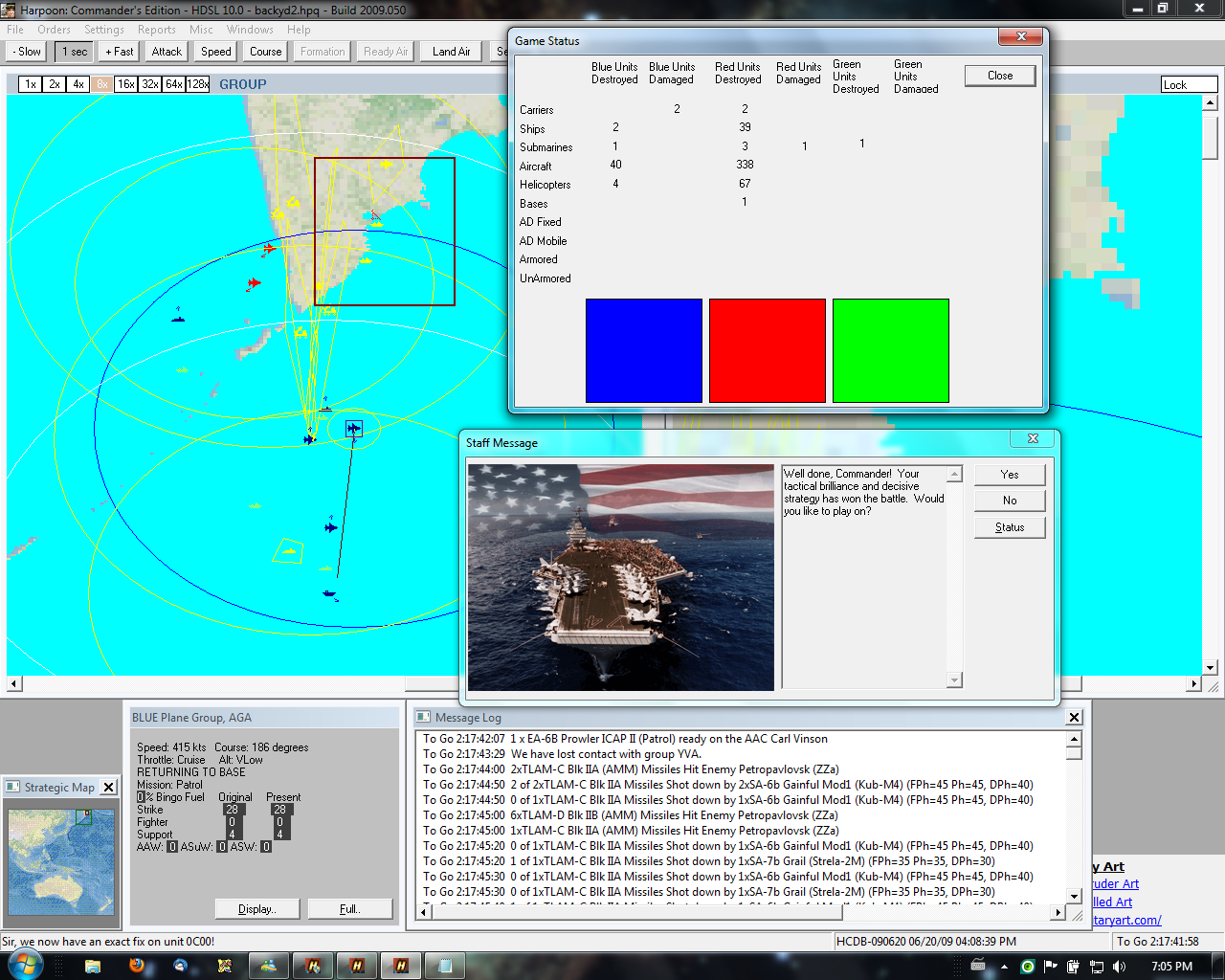

Part the last:
TTG 3:03:21:20 Patrolling F-14s claim another Bear-D.
TTG 3:03:07:50 Two more Badger jammers downed.
TTG 3:03:06:10 A pair of Mays are the latest victims of the Toms.
TTG 3:03:00:30 Strike escorts claim 3 Mays and 4 Helix, including an AEW variant.
TTG 3:02:52:00 Looks like the strikers killed the entire NNW surface group in one pass.
TTG 3:02:36:55 4 Tu-26 downed.
TTG 3:02:15:00 Another Oscar manifests itself, and once again, in spite of what should be overwhelming SAM and AAM defences, one of 20 SSMs gets through, damaging Carl Vinson to 22%. There is something very wrong here, because I'm not being jammed, but my missile defences are not working nearly as well as they should!
TTG 3:02:06:00 ... and now a torpedo attack coming in. Run Away!
TTG 3:01:46:45 A small group of Hornets kills a stray Kresta II that got hung up on an island.
TTG 3:01:35:00 A Victor III turns up in the area the torpedo attack came from. Vikings and Seahawks to intercept.
TTG 3:00:38:50 We manage to kill a Victor I off to the E. ASW seems to require a LOT of torpedoes.
TTG 2:21:15:50 2 more EW badgers shot down.
TTG 2:19:39:20 F-14s down 4 Backfires. Launching a major strike on Petropavlovsk.
TTG 2:19:35:30 ... and a Bear-F.
TTG 2:17:43:50 At the cost of 18 F-18s and 13 F-14s, Petropavlovsk succumbs to a combination of Walleyes and Tomahawks. Victory is awarded two minutes later.
This was a pretty good scenario. Although I started off quite well, I found it very difficult to maintain the high level of concentration necessary to keep losses to a minimum. At the end, for the strike on Petropavlovsk, I simply didn't bother to try. I suppose I could justify that by claiming that this was the last battle in the theater, and it was the final strike of the battle, and I knew I had the firepower to kill the base whatever losses I took, all of which was true, but the truth is, I wanted to get it over with. I could have loaded my Hornets up with SLAM, and whittled the SAM defences down, and that would have kept my casualties down, but it also would have taken another day or two to finish, and I knew I had the game won already.
