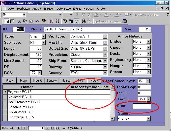

September 3, 201016 yr Would it be possible to add additional information fields to an already extant HCE DB without screwing up its compatibility with HCE? For example, adding a field to each record for the first date a ship in that class was commissioned and a another for the date the last one was taken out of commission. Such a thing is possible, yes, and won't prevent the exported database from working with HC.
September 3, 201016 yr It must be getting late, I just had a strange idea. Would it be possible to add additional information fields to an already extant HCE DB without screwing up its compatibility with HCE? For example, adding a field to each record for the first date a ship in that class was commissioned and a another for the date the last one was taken out of commission. Was thinking might just be possible as the added fields would not be expected by HCE and might just be ignored. Could use them for either the addition to the PE or just for myself. Done this long time ago...
