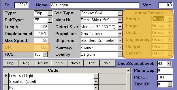

  2. I don't understand your question. When adding images you can usually use 256 color BMPs. The limiting factor is file size. Increasing the DP is the most direct route, yes. Heavier armor helps but increasing the DP should be your primary mechanism. I Understand ,tanks I expressed myself badly the question about the "old format" Thank you
  3. Thanks With regard to images of old-type scenarios (GIUK-NAVC-MEDC-IOPG etc..) Picture to 16 colors you can change them? Last question:) To increase the "resistance" of a platform (eg a ship) should only increase the DP Damage Point? Armor Ratings section does not have to select the types of armor (None-Light-Medium-Heavy-Special)? see attachments Thanks again for your time
