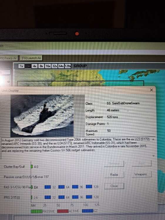

First, the edited Submarine entry 4107 for SemiSubDroneSwarm:
Not clear if is a single semisubmersible drone or a group of five drones, but not very relevant at last.

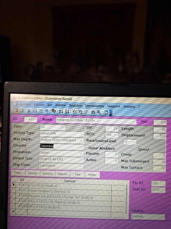

Attached is two photos, one of the modified/upgraded sensors in my personal use HCDB2 entry 4107 "Intrepido (U206A)", with CSU 83 main sonar and Kelvin-Hughes radar, and three other sonar systems added by me (The original 4107 "Intrepido (U206A)" has only the CSU 83 sonar).
In the edited entry 4107 for SemiSubDroneSwarm I see the CSU 83 has been replaced with Cluster Bay/Gulf, and the Kelvin-Hughes with a simpler periscope radar.
But the edited entry as SemiSubDroneSwarm keeps, I think is not pretended, my other three added sonar systems, i.e. SemiSubDroneSwarm keeps the other three sonars not showing only the pretended Cluster Bay/Gulf sonar, and that is a surpresive outcome, at least for me.

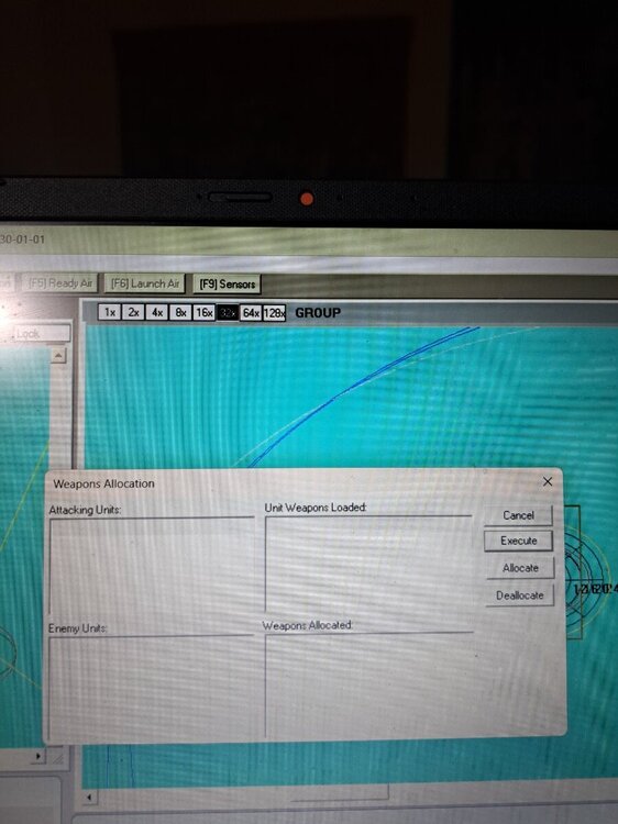

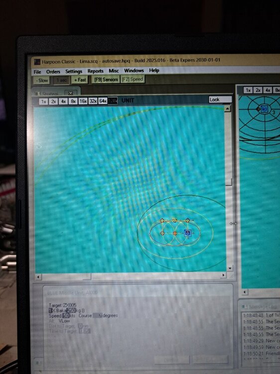

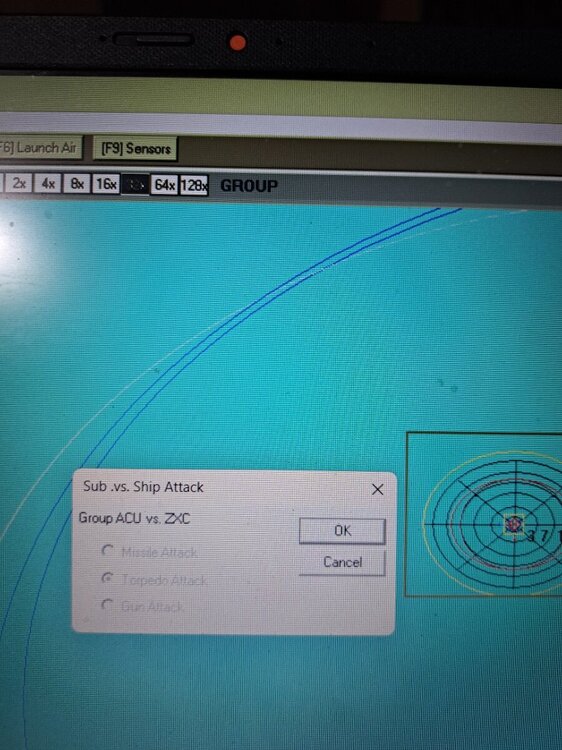

- Blank dialog about possibility of torpedo attack (photo 1), but the Baka is clearly at last a missile flying very low at 50 knots as showed in photo 2 (only later, perhaps when the SemiSubDroneSwarm are nearer to the targets, is opened a dialog permiting missile attack, allowing launch the Baka with effect in the target and destroying the launcher boat, as originally pretended).
- Another blank dialog (photo 3) popping up when the torpedo attack possibility is pressed, opening the dialog but showing none allowed target.
The annex changes by the export.dll only overright the sonar data of the first sonar and rely on the loaded database having only one sonar for the platform.  I think that is what's happening here. If you load hcdb2 (170909?) I think it will run ok regards this.
There is similar issue with mounts, the 'donar' platform needs to have the desired number of mounts.
As your screen shot shows there is also a desire to edit other data such as platform text, dimensions etc. If we can iron out the basics, such as the other issue you've uncovered then we can work on the niceties.

I've looked last night at the blank dialogs for attack and weapon allocation when approaching target but not within baka missile range. Also the guns which should not fire when snorkelling, I'm sure in ww2 scenarios the subs with guns will not do that so there is something that this in game amendment of annex is not achieving.
I am as an experiment replacing the guns with a second baka mount. I ran out of time to test that but I wonder if the blank dialogs might also be to do with the close range and multiple unit attacking and target groups. I do on occasion  see this sort of thing in other scenarios but usually not with such severe consequences.
