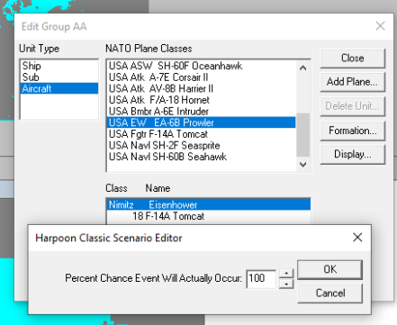

Hi Tony,
I can post screen shots, but the buttons appear to be active. Just not registering that I am clicking on them or when I switch user type.
On one screen shot you can see I pick the Nimitz class carrier and then I switch to Aircraft under unit type, but it does not give me a list of aircraft. Also I can click on close, add unit (after adding the carrier), formation, and display and nothing happens. The only button I can click on is the x in the top right hand corner. The good news is it will add the carrier and I can go back in and add a plane unit then.
In the second screenshot you can see I can add another unit, but as before after selecting that unit the problem happens again.
It is like after the first time I click those buttons, they all are disabled afterwards.

I was just playing with the SE today and I got this to pop up.

On 4/9/2022 at 8:43 PM, Hawkeye065 said:
Hi Tony
I am getting the percent dialog right after I hit the x button in the top right hand corner of the screen. I tried the patch in your last post but no dice.
Hi Hawkeye,
Can you drag the main box to another part of the screen to see if the percentage dialog is hidden under it (for some reason)?
Don
Hi I moved the dialog box around the screen and there was nothing behind it. When adding the unit the percentage box appears and I can hit okay to add the unit.
I circled the x button at the top right hand corner of the dialog box. This is the only button that is available to click on once I add the unit.
The other buttons appear to be available, but when I click on them, nothing happens.
Also, I noticed the other day that if I click on the display button and exit out of the unit I am reading about, the same issue occurs and I have to press "x" on the dialog box to get it to close and re-enter.
One more thing. Once I hit "x" on the dialog box, I get  the percentage box again for the group to be in the scenario and I can click okay and it will add the group.
