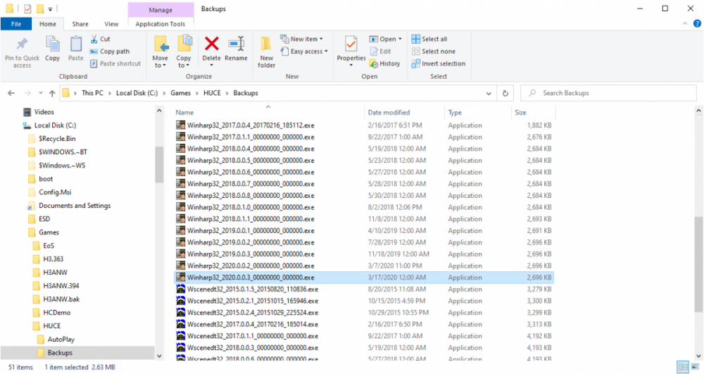

July 7, 20206 yr Tony, that is a bummer, I was hoping that was fixed. You definitely aren't running low on memory, HC uses barely any in today's terms. What feels like overwhelming of RAM is more likely the accumulation of buffer overruns corrupting the state of the game. Re-loading 2020.003 shouldn't make a difference but it would be an interesting comparison. If you made a backup of your old install or left it in place you should have a Backups directory under your main HC directory that has the replaced files (see attached as an example from a machine here). So you would copy the Winharp32_2020.0.0.3_00000000_000000.exe back into your game directory and run that to test 2020.003. If you don't have it, holler and I'll send you a link to 2020.003. More importantly, would you be able to send me a zipped saved game from immediately after you set up your formation patrols? I may be able to use that as a jumping off point to debug based on friendly aircraft running out of fuel and painstakingly trace is backwards. Thanks!
