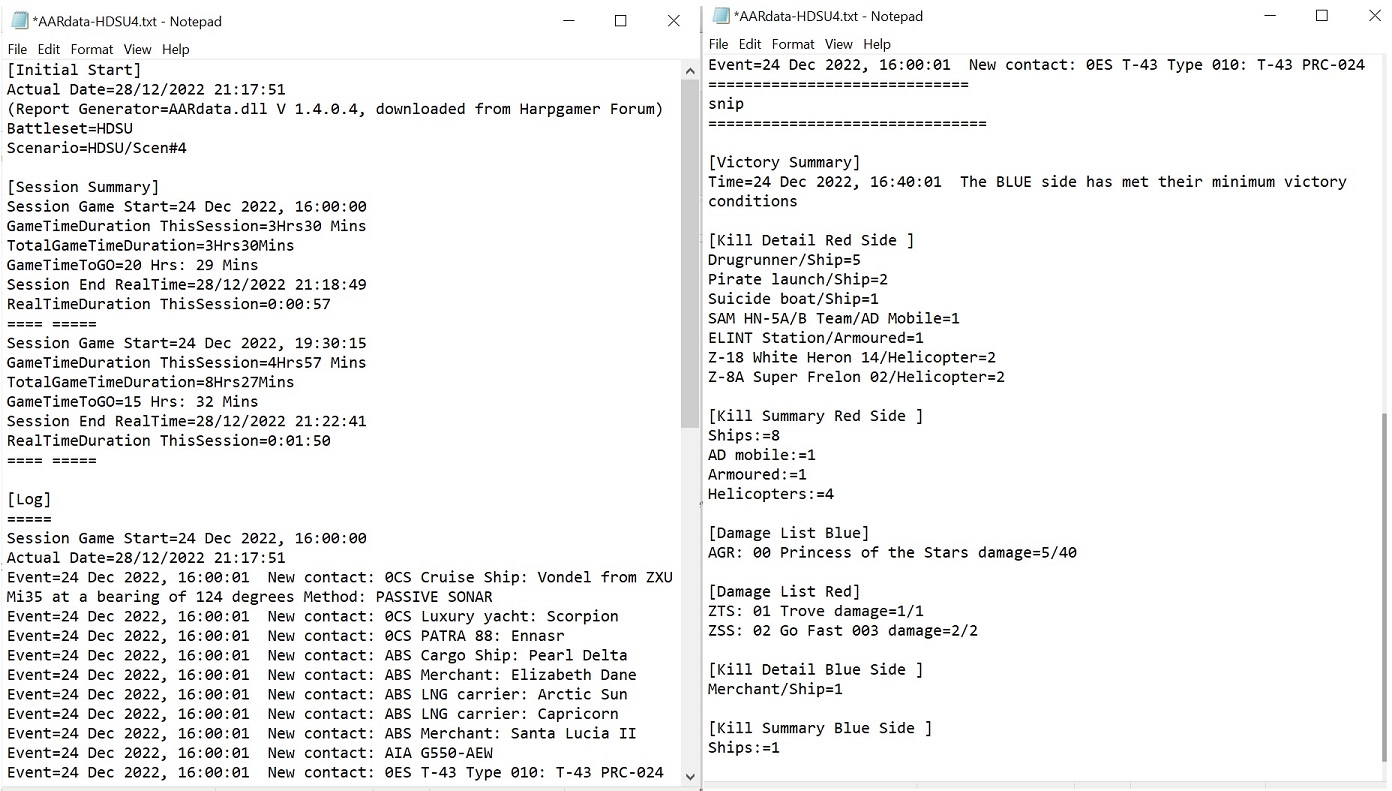

The DLL will produce at the close of a game or game session a txt file AARdata-(battleset file name)(scenario number).txt. (Scenario number for custom scenarios is '0').
Within the txt file the report is made up of titled sections providing:
Scenario information,
Initial Start information,
Time information for each session of play
Detailed game log messages in time order
List of units destroyed for each side in summary and in detail
List of damaged units at time of game close and
List of changes to game time compression.
