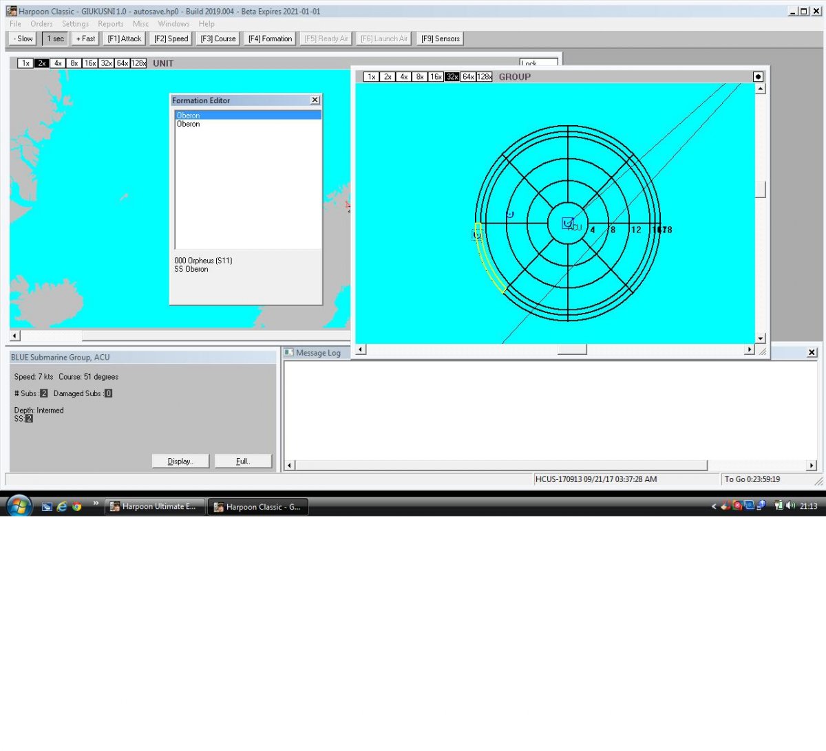

My dad has been playing harpoon and noticed there was a problem in the beta update when he was playing, but bare in mind he is running this game in vista.
In this picture there are some icons missing for the range and aircraft patrols for the formation editor.
will there be a patch that can fix this problem? or would he have to go back to the earlier version before the patch?
Many regards
Matt
Thanks for writing, when the game isn't running, run the utility at
It does as the description lists and clears some registry key.  That allows the windows to properly size themselves when you next launch the game.

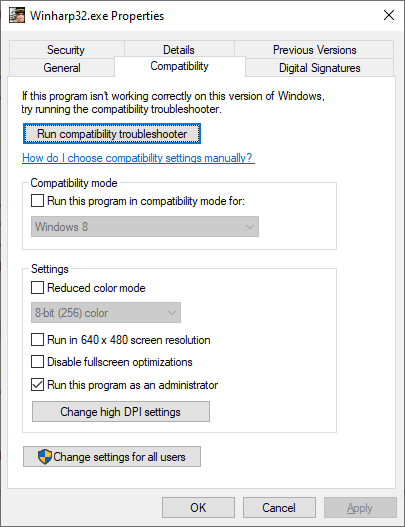

Regards of running the game we opened it up in the launcher. so we opened up up all older version of the game and they run ok, but when it came to Harpoon CE it wouldnt open up as normal, so my dad clicked on winHarp32 and it started to run, but from the previous post i have given you the images that came up once we ran it in WinHarp32
Many regards
Matt
99% chance that right-clicking on Winharp32.exe and doing Run as Administrator will do the trick for you.  The license checker provided by Matrix Games unfortunately requires administrative permissions (which it doesn't need...) to function properly.
You can have it launch that way all of the time by right-clicking on Winharp32.exe and click Properties, then head to the Compatibility tab and check the box for "Run this program as an administrator" and click OK.
