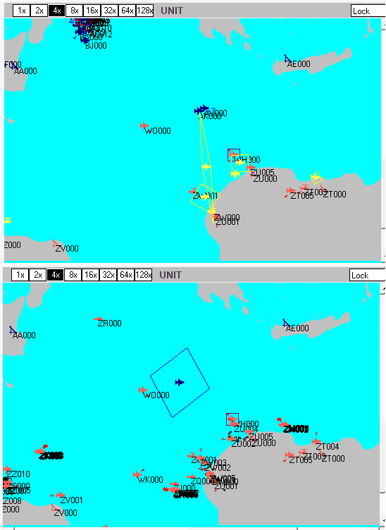

The 1st screenshot shows two groups of F-117A and F-22A off the coasts of Libya from blue point of view.
The 2nd shows the same save file from red point of view after it was turned by turncoat. This is what the AI detected of them.
