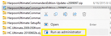

Please try running the installer with administrative permissions.
I would also make sure to install the most recent patch after that installation.
https://ftp.matrixgames.com/pub/Harpoon-UltimateEdition/HarpoonUltimateCommandersEdition-v2022027.zip
I'll reiterate that once you have the game installed, you shouldn't need to reinstall, that's almost always a waste of time for HC.
