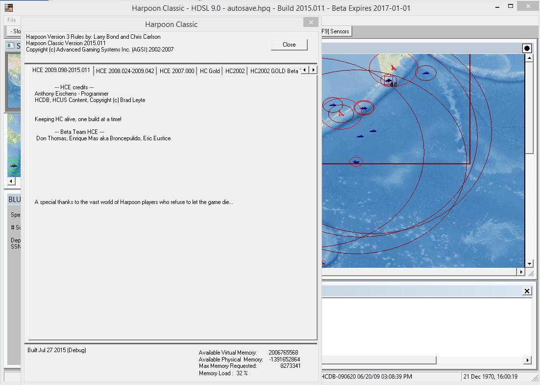

July 30, 201511 yr Matrix just released the HUCE 2015.027 patch (yay!). A side-effect is that it is not currently possible to bring HCE up to the current beta version. This may change in the future as more components are updated again. A method of updating HCE (Harpoon Commander's Edition) to the current Beta versions. Note, this is not for HUCE (Harpoon Ultimate Commander's Edition). For HUCE, download and install the 2009.097 patch from Matrix Games, then install any Beta versions on top of that.1. Have HCE installed. I'm installing HarpoonCommandersEdition-SetupRelease-DR.exe to accomplish this step. The resulting version is 2007.000. For this exercise I'm installing to C:\Matrix Games\HCE2. Install the 2009.050 update from Matrix. I'm installing HCE-UpdateComprehensiveInstaller-2009.050.exe. The resulting version not unexpectedly is 2009.050. Make sure you specify the same installation location as 1. since it is possible for the installer to pick up the wrong location when it initially guesses.3. Install the current beta from HarpGamer, http://harpgamer.com/harpforum/index.php?/topic/2049-current-files/. I'm installing HC2015.011GESEBS.zip. Yes, the instructions at that page say to install over the 2009.097 update but things work even from 2009.050.If you have difficulties, let us know.
