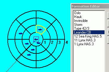

Sequence to reproduce:
1. Change zone size for formation to 1nm, 2nm, 3nm, 4nm.
2. Re-position ships by ordering them to the same zone they occupied before the ranges were changed

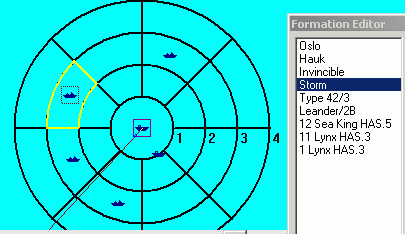

3. Run at high compression to allow ships to move to patrol zones
4. Hit Formation editor.
5. Re-order Storm into it's zone (marked in Yellow).
6. Do NOT issue formation orders for any other ships.

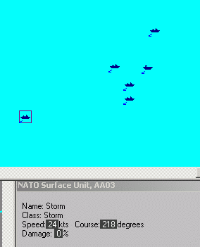

7. Run at high compression.
8. Storm races ahead and 'out' of the formation.
