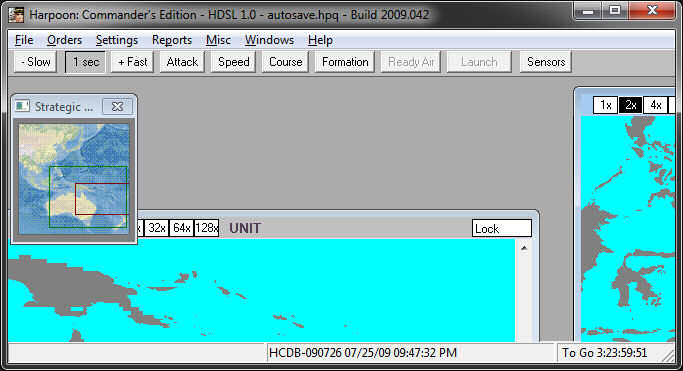

October 26, 201016 yr If you have a fairly recent version it will show up in the title bar. In the attached image you see 2009.042, that's the version. I'll take a look at your combo of battlesets and scenario tomorrow night. If you run across your version number, please post it.

October 26, 201016 yr No version number in the title bar so I must have an older version. Where do I get the new version? Yes, that is probably a contributing factor. You can find your version number in Help\About. It will be in the form of year.build (2007.000, 2003.16b3,...). If you have 2007.000 or newer you can grab 2008.044 from http://www.matrixgames.com/products/325/do...r%27s%20Edition Once you have installed that, grab 2009.042 from http://harpgamer.com/harpforum/index.php?showtopic=2049 In the off chance you are working with an earlier version than 2007.000 the newer battlesets won't work and you'll have to buy a newer copy of the game from MatrixGames.com if you want to use those battlesets.
