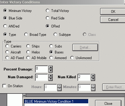

Long Description: Test scenario has ViCond set at the destruction of two bases. Victory is granted after just one base is destroyed.
Sequence to reproduce:
1. Play as Blue.
2. Launch bombers and kill one enemy base.
3. Victory awarded.
4. Test scen attached.
Expected behaviour: Victory after destroying two bases.
Observed behaviour: Victory awarded after destroying just one base.
