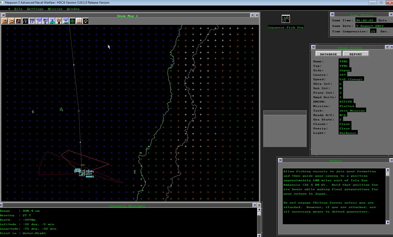

Mark,
one hint for scenario writing with H3 ANW: create a tactical map and open a few windows. This is nice for the player when he starts the scenario for the first time. Attached a screenshot which si rather typical for the windows arrangement in H2/H3/H3 ANW.

Mark,
