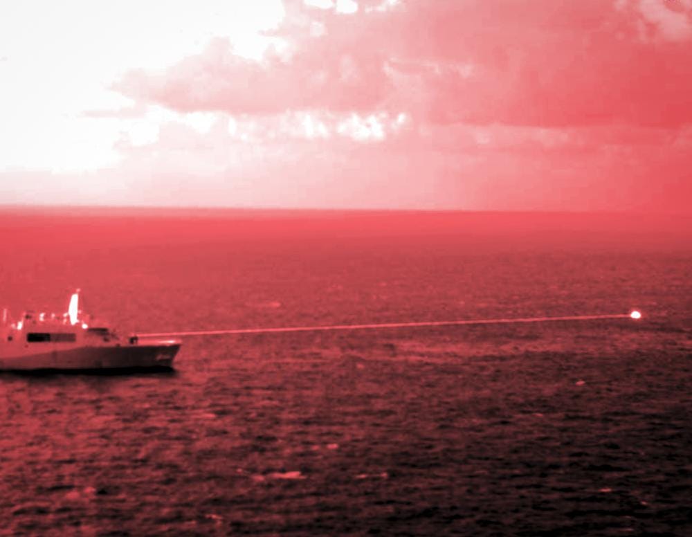

The image at the top? That is the same one I used in 2021, and it caught my eye when I saw it again yesterday.
We already have some preliminary designs that have gotten some good use forward, but what can help give it the push it needs to get installed on a greater number of ships?
Well, the Chief of Naval Operations on Wednesday had an op-ed at WaPo on…lasers...and he used the same image.
Admiral Caudle, over to you.
