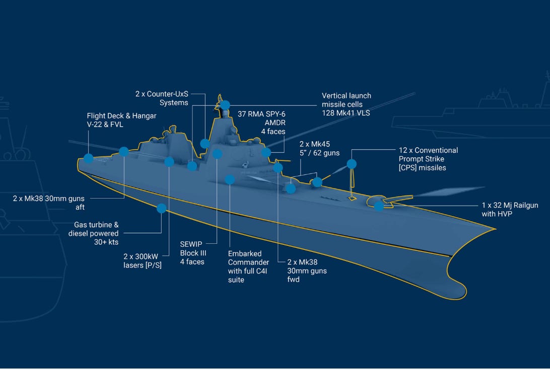

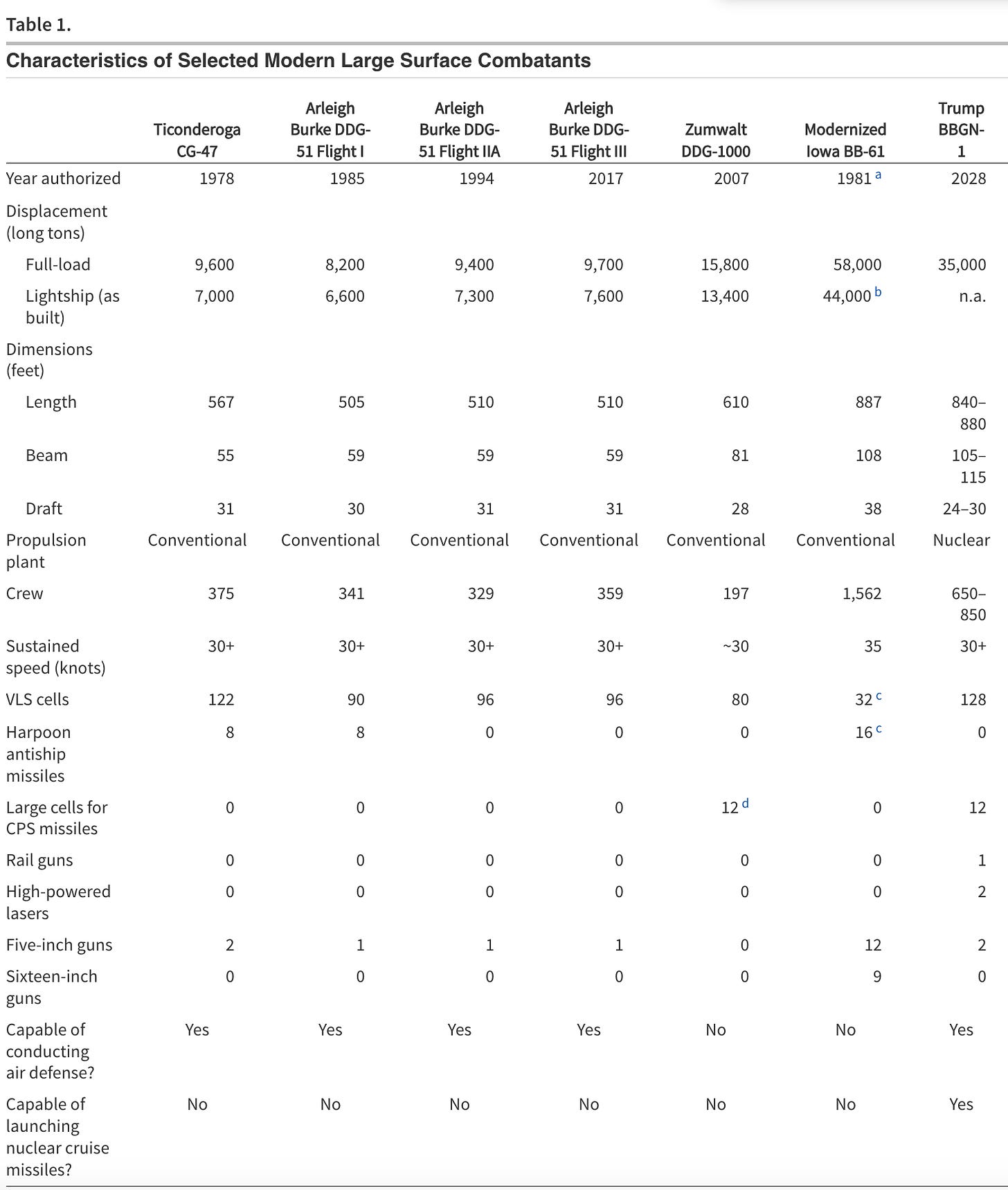

We’ve gotten this far without reminding everyone of the scale of BBGN-1, so let’s reestablish that baseline understanding.
The battleship would have a full-load displacement of 35,000 tons or more, a length of 840 to 880 feet, and a sustained speed in excess of 30 knots.3 The Navy revealed those specifications before deciding to use nuclear propulsion on the ship, a change that would significantly increase the cost of the ship and affect its design.
If built to those specifications, the ship would be the largest surface combatant in the world and larger than any surface combatant built for the Navy since World War II.4 It would be more than three and a half times the size of the Navy’s Arleigh Burke class guided missile destroyer and more than twice the size of the Zumwalt class guided missile destroyer
A few notes on the above.
  1. 128 VLS cells is what we had with the TICO CGs. There is expanded news here that I will cover with the sidebar at the end of this post…but stick with me here and don’t get distracted. We’ll get there in a bit.
  2. I remain unhappy with just 12 Conventional Prompt Strike missiles, but compromises must be made.
  3. That damn SLCM-N is still there. It is a bad idea, distraction, and unappreciated cost inflator. Again, just say “no” to the nuclear autists.
