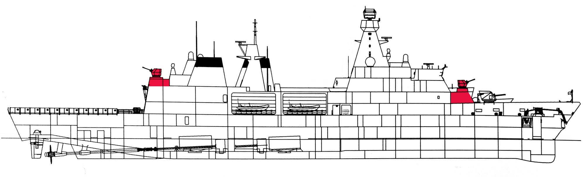

The incoming Type 31 frigate for the Royal Navy, and a few export customers, has two of these in addition to its 57mm main mount (NB: really should be at least 76mm, but you know my biases).
Look where these are located on this ship. It shows some flexibility on where these can be installed on other ships.
