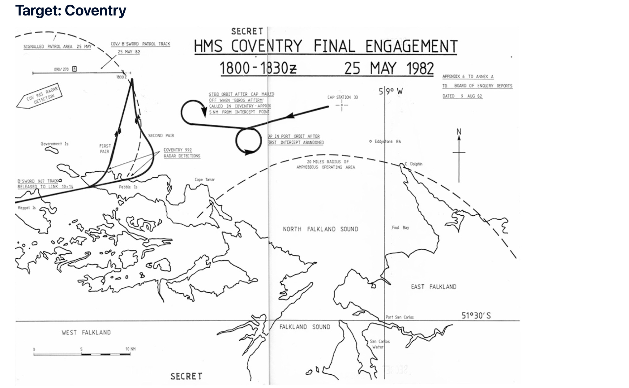

Second big takeaway from this engagement is damage control. Read the board of inquiry report.
I offer you Captain David Hart-Dyke and the crew of the HMS COVENTRY. Get a cup of coffee and watch it all. I'll let them take it from here.
