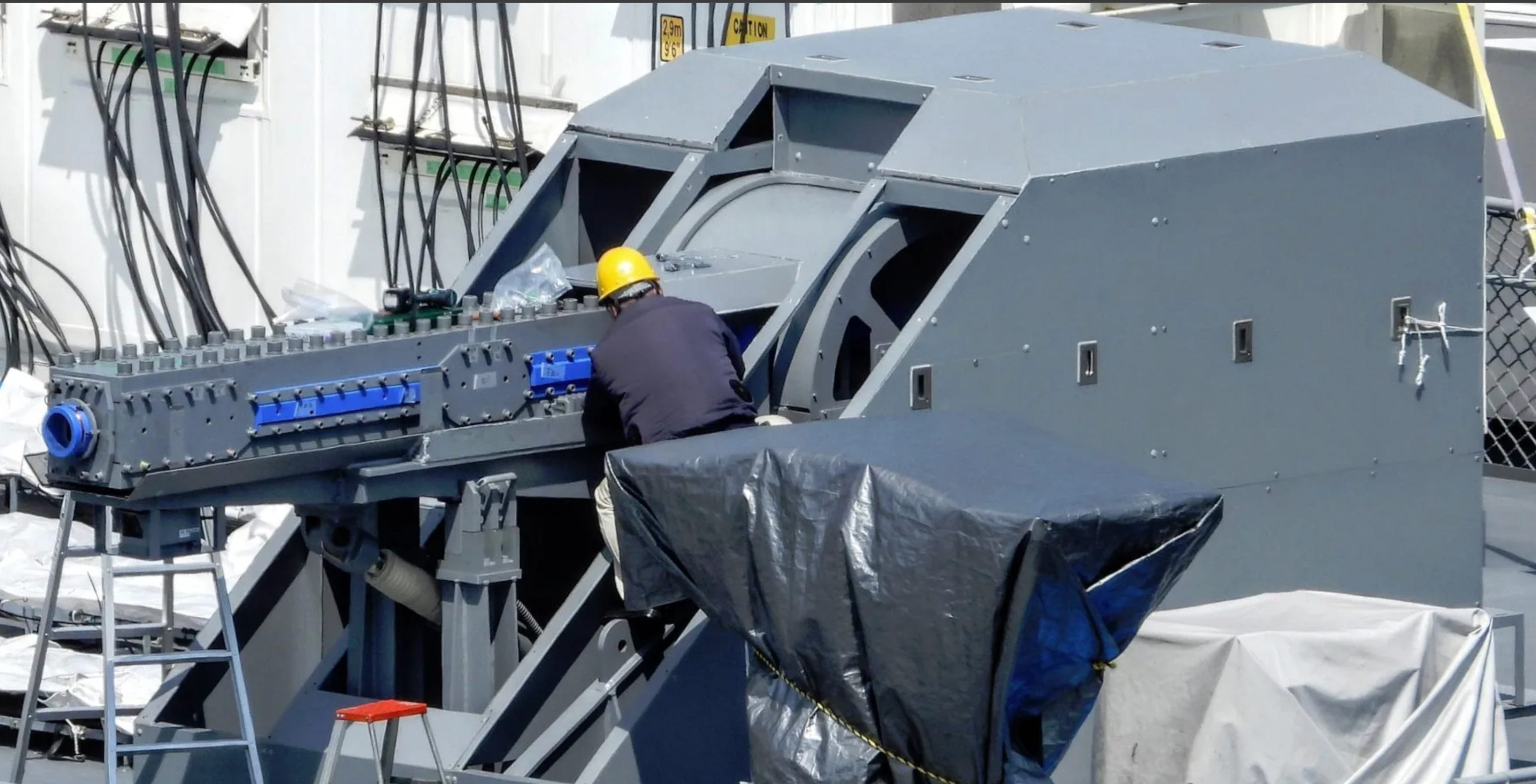

New pictures have emerged showing work being done on the Japan Self-Defense Forces’ prototype electromagnetic railgun currently installed on the test warship JS Asuka. An at-sea test of the weapon in this configuration is expected to come before the end of the month, if it has not occurred already. Japan’s continued developments in this realm stand in notable contrast to the U.S. Navy’s shelving of its promising pursuit of this category of weapons in the early 2020s after major technical hurdles emerged.
The images of Asuka and its railgun in port in Yokosuka, seen at the top of this story and below, come from @HNlEHupY4Nr6hRM on X who originally posted online. All of the images were taken on June 30. Additional photos of the ship taken recently are also circulating online. Asuka, a 6,200-ton-displacement dedicated testbed with a warship-like design, first emerged with the turreted railgun on its stern flight deck in April.
Crawl, walk, run?
In past testing, ATLA has reportedly demonstrated the ability to fire rounds at a velocity of around 4,988 miles per hour (2,230 meters per second; Mach 6.5) while using five megajoules (MJ), or 5 million joules (J), of charge energy. As of April, prior testing goals had included a muzzle velocity of at least 4,473 miles-per-hour (2,000 meters-per-second) and a barrel life of 120 rounds, according to Naval News. Reports say that ATLA has also been working to reduce the weapon’s power requirements.
