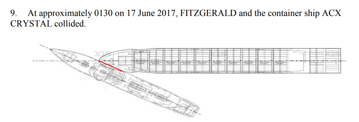

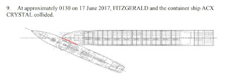

The supplemental preliminary inquiry into the collision involving the USS FITZGERALD (DDG 62) and the ACX CRYSTAL from 17 JUN of this year is out.
The report is dated 11 AUG 17. You can get it from the SECNAV's site here, or read the whole thing posted below.
