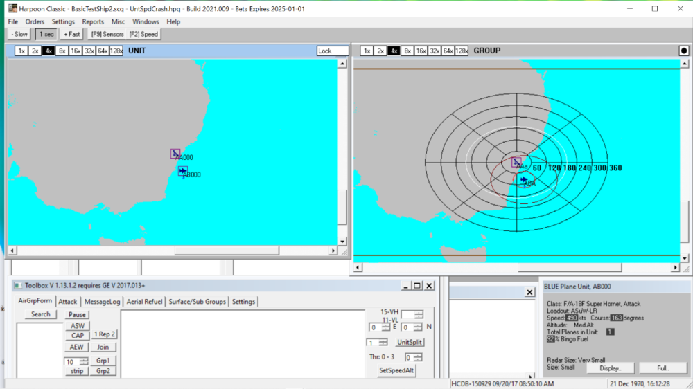

I tried HCDB and HCDB2, three separate scenarios within westpac battleset, two custom and one battleset scenario (#1), all consistent crash.
Air units either in a patrol around a base or as '0' unit in an air group, select in unit window and select "speed" button and game crash every time.
(rather disappointing as I got very excited when I saw it :) )
zipped test save UntSpdCrash attached, std HCDB database westpack battleset GE 2021.009
Select air unit in unit window and mouse click 'f2 Speed' button and game will crash.
UntSpdCrash.zip

GE fixed so that your test case of an aircraft unit in a fixed base group no longer crashes the GE.  Test scenario uses HCDB2.
