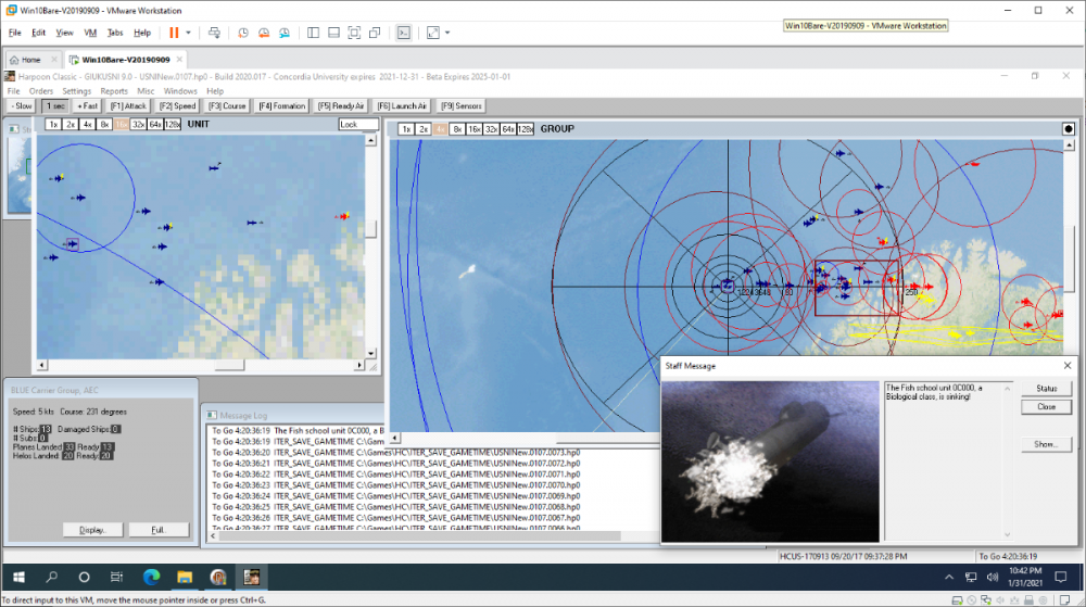

Jean Posted January 29, 2021 Report Share Posted January 29, 2021 same result with GIUKUSNI9.0. autosave.0110.hp0 autosave.0109.hp0 autosave.0108.hp0 autosave.0107.hp0 autosave.0106.hp0 Quote Link to comment Share on other sites More sharing options...

Jean Posted January 31, 2021 Report Share Posted January 31, 2021 On 1/29/2021 at 11:45 PM, TonyE said: Jean, if you do Retry to debug, does it happen to give you additional information like a call stack? Hi Tony, here is what I did get this morning. Quote Link to comment Share on other sites More sharing options...

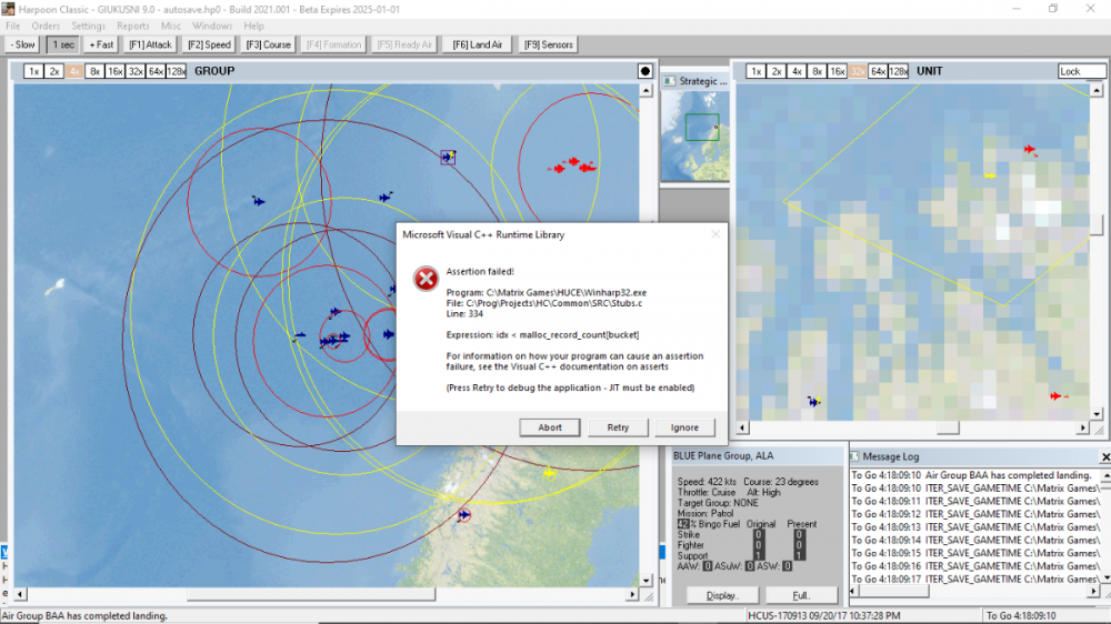

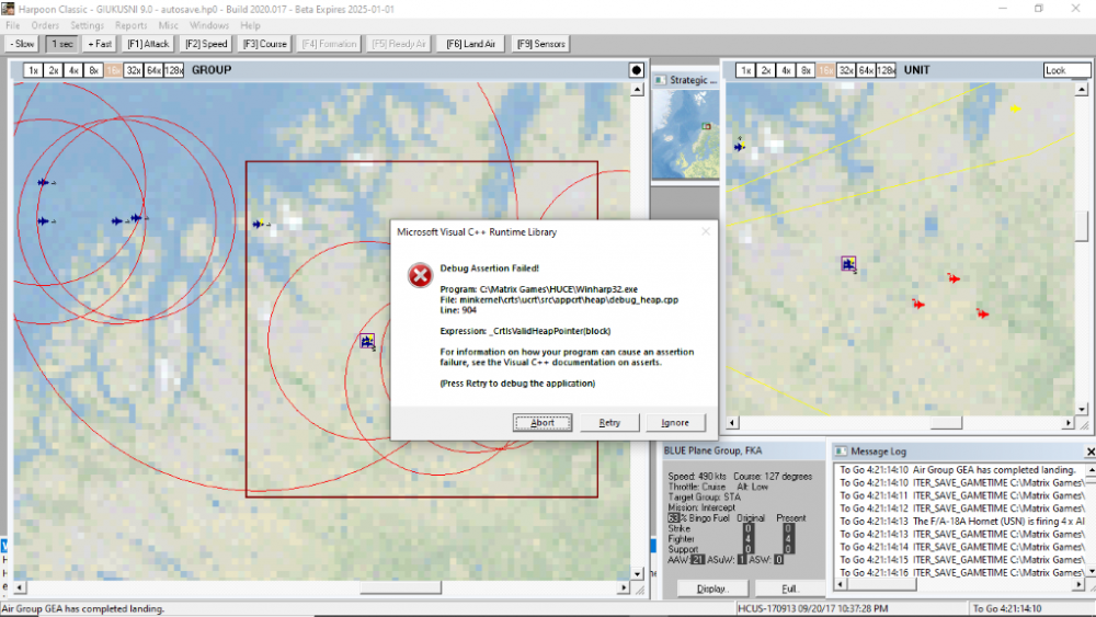

TonyE Posted February 1, 2021 Author Report Share Posted February 1, 2021 Since throwing darts at the wall isn't getting us very far, though it was super fun to challenge those Flankers in the re-worked USNI BattleSet, I'm just starting to compile a list of tools and techniques to troubleshoot. Historically instrumenting the game code along with play testing would isolate issues but memory corruption tends to build up over time and can rarely be tracked back to a single event. Over the next few weeks we should be able to start using these strategies to identify memory issues and begin cleaning them up. Quote Link to comment Share on other sites More sharing options...
TonyE Posted February 2, 2021 Author Report Share Posted February 2, 2021 While starting to lay out instructions for using windbg and gflags (from Memory problem debugging) I managed to see some heap corruption on a test machine then managed to get an error on my development machine. I've cleaned up an out of control Staff Assistant and no longer seem to get either of those problems. It may well not fix Jean's problem but it would be great if you can re-test with 2021.001 or newer. Thanks! https://harpgamer.com/harpforum/topic/29035-current-files/ Quote Link to comment Share on other sites More sharing options...
Jean Posted February 5, 2021 Report Share Posted February 5, 2021 On 2/1/2021 at 11:26 PM, TonyE said: While starting to lay out instructions for using windbg and gflags (from Memory problem debugging) I managed to see some heap corruption on a test machine then managed to get an error on my development machine. I've cleaned up an out of control Staff Assistant and no longer seem to get either of those problems. It may well not fix Jean's problem but it would be great if you can re-test with 2021.001 or newer. Thanks! https://harpgamer.com/harpforum/topic/29035-current-files/ I did play with new beta. It did took longer to crash and the error message were different. autosave.0049.hp0autosave.0047.hp0autosave.0048.hp0 Quote Link to comment Share on other sites More sharing options...
TonyE Posted February 5, 2021 Author Report Share Posted February 5, 2021 Thanks Jean, I'm disappointed we didn't magically fix everything but am heartened a bit at the change in error messages. Quote Link to comment Share on other sites More sharing options...
