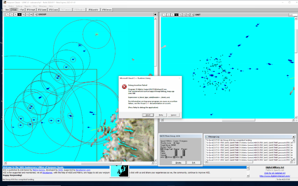

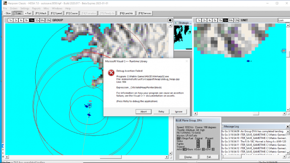

TonyE Posted December 27, 2020 Report Share Posted December 27, 2020 A user from the Great White North, recently returned to the game is experiencing memory corruption in the original USNI BattleSet, Scenario 5.0. He has experienced this both in 2020.009 and 2020.017. Some saved games are attached. I have tested extensively using AutoTest and have not replicated either issue (game exiting with heap corruption error [USNI5.zip] nor game exiting without any warning [NoErrorCrash.zip]). Right after the USNI5.zip saves a Slava is sunk but does not trigger a crash for me. The user has mentioned doing a lot of air group splitting and joining while playing. I view that as a valuable hint as very few players exercise that functionality and it is an area of the game prone to bugs. The latest hint is that the crash may occur when an air group is landing, perhaps an hour of play after the USNI5.zip saves when loading from the saves. Quote Hi Tony, I did reload the savefile autosave.0040 yesterday and I did crash again about after a other hour of play. Same error message same line of code. I am thinking a something. I just look back at all the screen capture that I did already send to you. It seems that the crash always happen when a group of plane just finish there landing. Any help narrowing down these crashes is greatly appreciated! USNI5.zip NoErrorCrash.zip Quote Link to comment Share on other sites More sharing options...

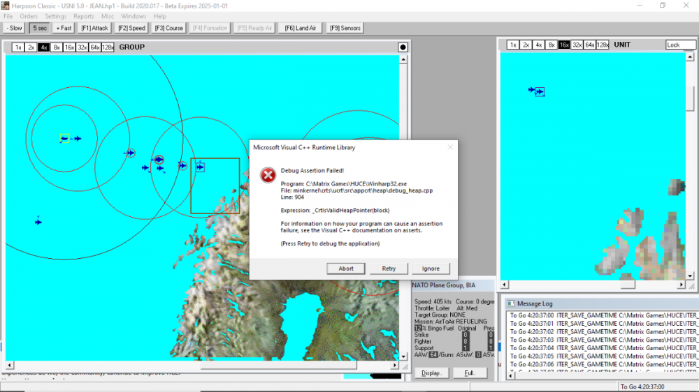

Jean Posted December 30, 2020 Report Share Posted December 30, 2020 I did more tests. You will find more information in the attach files. The detail information of my third try is within the document. HUCE crash with USNI 5.0 build 2020.017.docx Quote Link to comment Share on other sites More sharing options...

Jean Posted January 24, 2021 Report Share Posted January 24, 2021 Hi Tony, the Friday's Zoom session was interesting. Thanks. As you already know I had a similar crash playing the Red side on different Battelset. I did the test again on a different computer with a different security software. This time the security software was ESET Antivirus. same result. JEAN.0059.hp1 JEAN.0060.hp1 JEAN.0057.hp1 JEAN.0058.hp1 Quote Link to comment Share on other sites More sharing options...

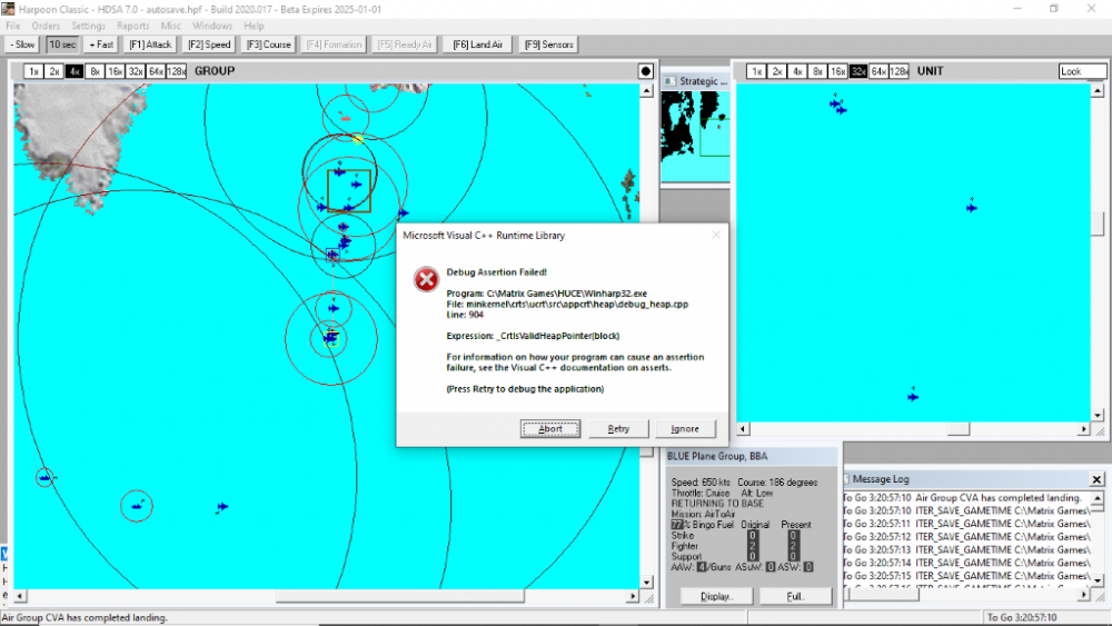

Jean Posted January 27, 2021 Report Share Posted January 27, 2021 The problem is not limited to USNI battleset. I had the same crash twice on the "bee hive" scenario of the battleset HDSA. Reloaded using autosave.0050.hp2 then Crash landing a plane on a carrier both time. I will happy to test. Quote Link to comment Share on other sites More sharing options...
