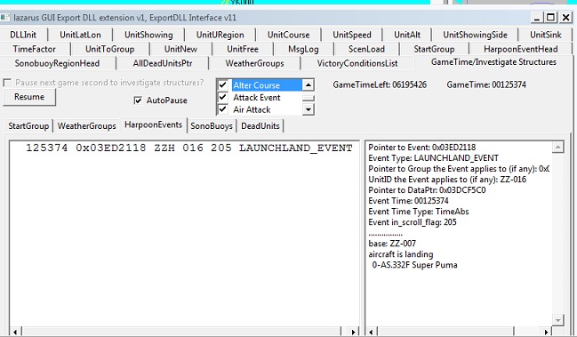

This is a modification of TonyE's lazGUI.dll.   It isn't a tool for game play per se but for those interested it does expose some of the game internals.
It adds for certain selected event types an automatic game pause when they are queued by the main program and showing information regarding the respective event. It provides certain information not seen in the game but useful for better understanding game operation. It includes game/scenario/database information handy to provide with reports to HarpGamer.
Examples of Database information is given for units selected from group list. Included is for group selected or Unit selected the UUID.
Within Start Group you have the ability to 'destroy' groups and units, should you wish to remove them from the game for testing reasons. NOTE THIS CAN CAUSE A GAME CRASH so always save the game before such action.
There are various buttons DRONE, KING which alter the loaded database annexes for selected groups as a bit of a giggle and a trial of early annex manipulation.
During start up the message is shown indicating if you are starting a new scenario, a follow on session of a saved game or a saved game out of sequence, ie you've not opened the saved game that you had last run.
If you are running add-on AARData then a table of stores consumed by each side, both general and aircraft by home unit are shown.
The size and position of the consul is retained for next game start, the information held in the file 'LAZGExtn.xml' in the HUCE folder.

TonyE's latest additions to the exportDLL capability has meant that we can get quite a large amount information from the database in use.
I've added to the start group page/tab so as to dump some of this for any unit selected from the unit list of a selected group.
This will allow certain functions in my ToolboxDLL to be overhauled for better accuracy/ simulation and undoubtedly more functions developed.

The latest version is up tonight. I've made sure in the StartGroup tab the unit information includes magazine content and mount (including mount ammo) where such exist. This should help test the custom data base for those errors. If people will use this often, and would find it easier, the units list can be changed to a straight list of all current units independant of their group.
It requires that you write a scenario including the units you want to check.
It could also be altered so as to list all units with in the database (I think) but that would be quite long so perhaps not best.
This hasn't been thoroughly tested so let me know if you see suspicious data.
