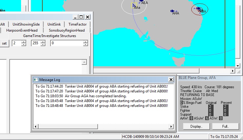

So far I've been able to manipulate in a refuel: the fuel transfer amounts, which units receive fuel and the order; refuel other tankers and refuel multiple times from the one tanker (see attached jpg and note the refuelling episodes about an hour apart from the same tanker unit to two strike units.
I have to decide on some calculations for updating available fuel after each transfer, how to get the whole thing started, how to prevent 'cheating' and an interface.
Allowing a tanker to provide fuel on multiple occasions to multiple aircraft (whether unit or group), and moving past the old "one time use" scheme is by far the most important hurdle, imho.
